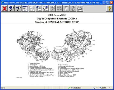

https://images.2carpros.com/forum/automotive_pictures/416332_2001_coolant_temp_sensor_8.jpg
Sound's like you have a bad coolant temp sensor with what you describe.I posted a diagram of where your coolant temp sensor is.It's screw's into your head pretty common for them to go bad on that model.Make sure you get a brassed tipped one the plastic tipped one's crack.Also inspect the connector going to it if it's corroded then replace the connector as well.Make sure the engine is cold you will loose coolant.Let me know what you find.

THANK YOU SO MUCH also is there anything I can do with the computer probelms ? its not a bad computer.. its just need the *drive cycle* and I heard I might have to take it and get this done by a pro for 89.99 .. so.. any fixes for the OBD II ?
Jun 9, 2010 at 6:05 PM
SATURNTECH9
  • 30,869 POSTS
If your talking about reseting your monitor's then take care of your coolant temp sensor problem make sure all your code's are clear then drive your car for atleast 50 mile's without turning the key off.That usually reset's them.Let me know how you make out.
