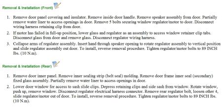

how do i replace the power window motor on my 97 saturn

https://images.2carpros.com/forum/automotive_pictures/261618_Noname_2714.jpg
