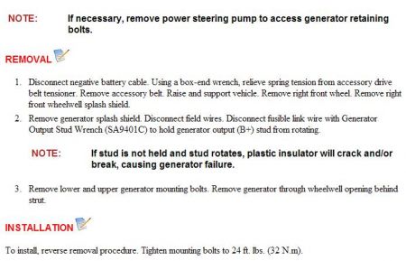

1997 Saturn SC1 Alternator replace
1997 SATURN SC1
RDNKCRACKER
Electrical problem
1997 Saturn SC1 6 cyl Front Wheel Drive Automatic
are there any special tools needed to change out the alternator? I read that all you need to do is jack up the car take off tire remove wheel well liner and then replace only two bolts to mess with.

https://images.2carpros.com/forum/automotive_pictures/261618_Noname_1151.jpg
