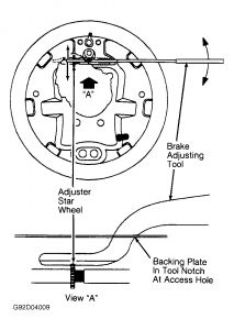

1996 Saturn SC1 rear brake drums
150,000 MILES • 6 CYL • FWD • AUTOMATIC
TVENN3
how do you remove the rear brake drums. I tried spray lub around the hub already...thx

if drums seem stuck, insert a thin screwdriver through the hole in the backing plate. hold the adjuster lever away from the star wheel and use brake adjuster service tool to rotate the star wheel to contract the brake shoe
https://images.2carpros.com/forum/automotive_pictures/261618_Graphic_507.jpg
