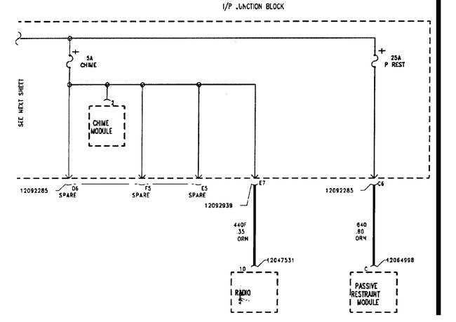

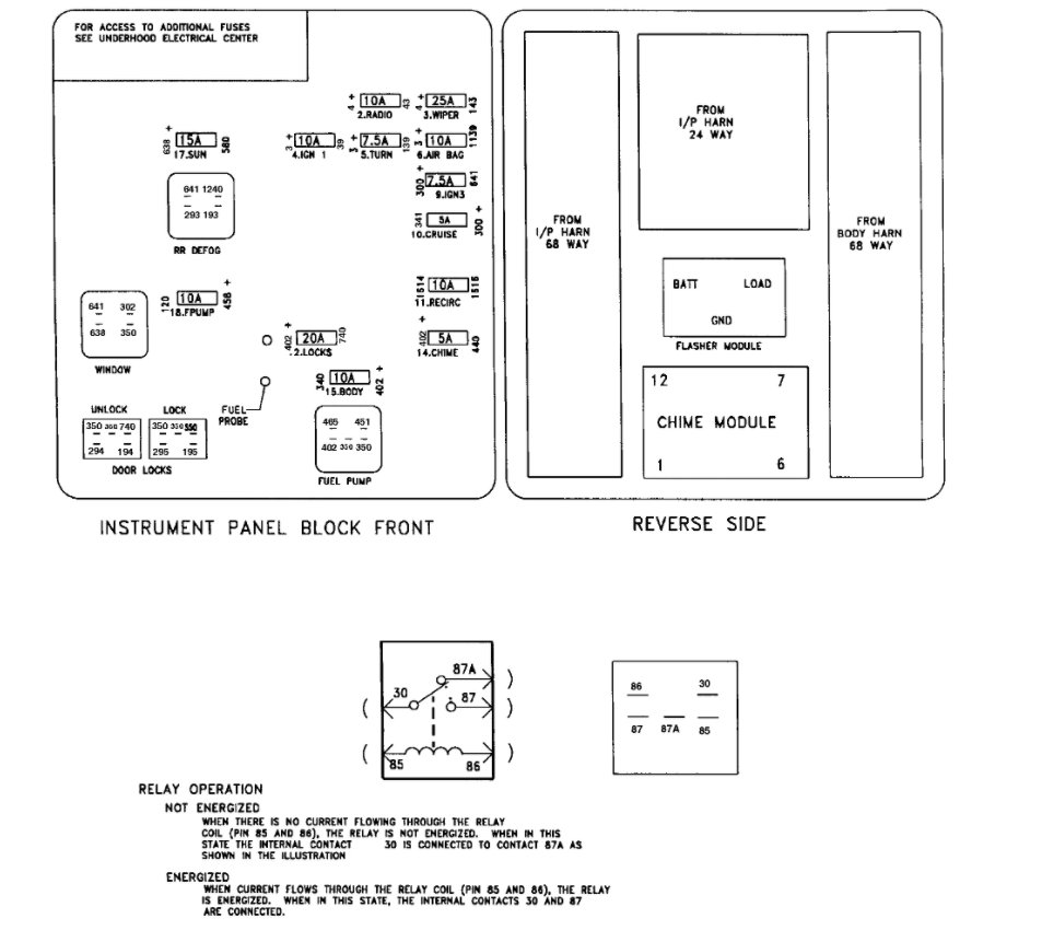

Can I get a fuse box diagram please? I need to do some testing

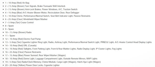

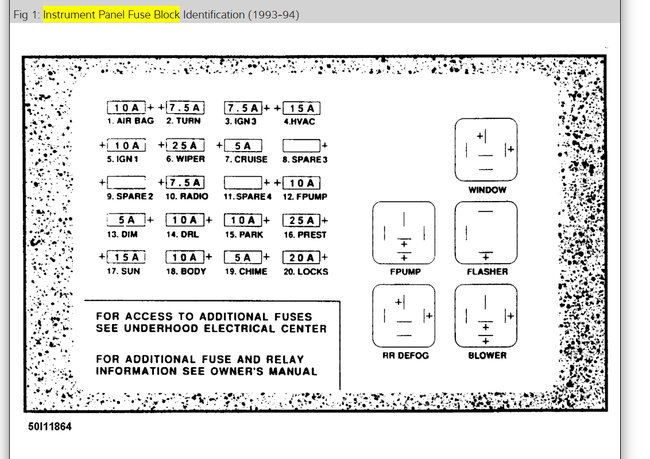

Hello, here is a guide to helps you check the fuses with the fuse panel diagrams below.

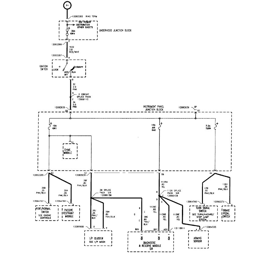

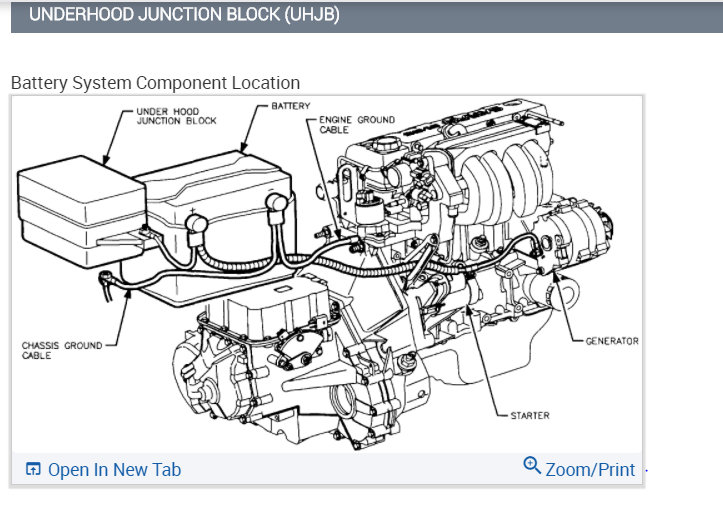

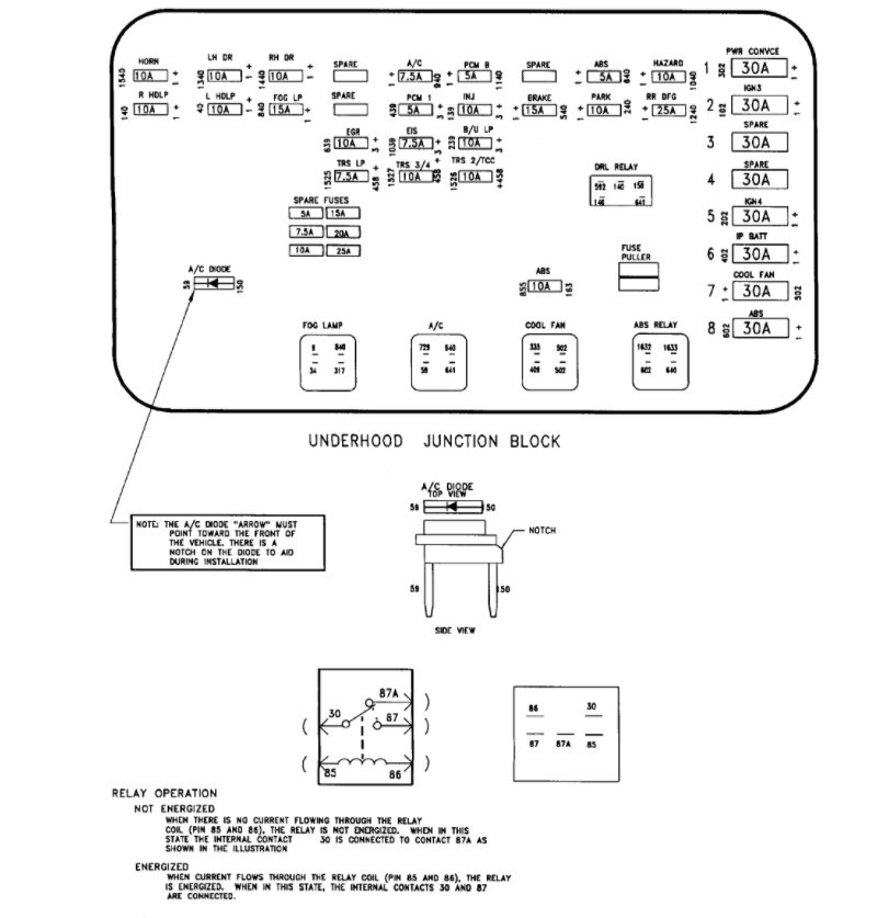

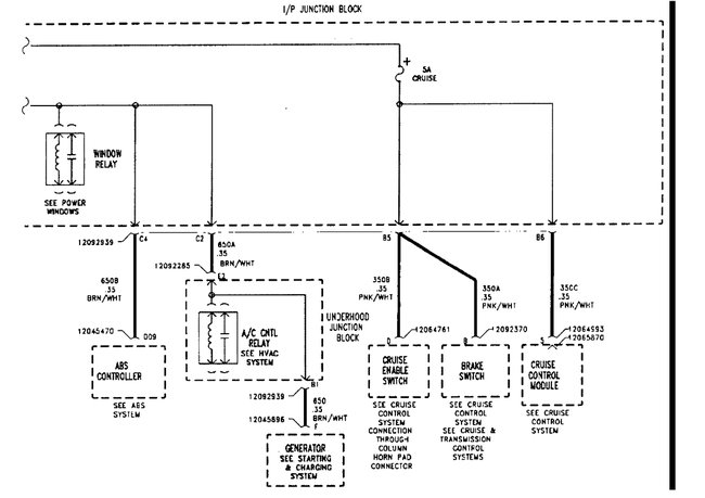

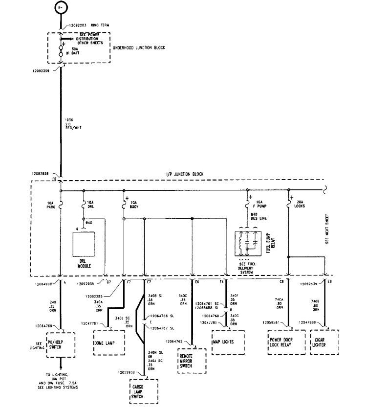

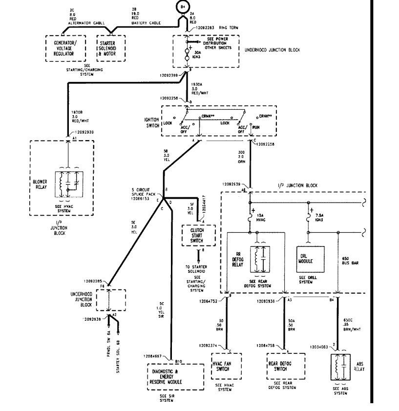

The information that you requested is in the diagrams down below. Saturn did not make an actual diagram available for your vehicle's fuse panels but I included all of the Power Distribution Wiring Diagrams so you can get specific circuits fuses and numbers from them.

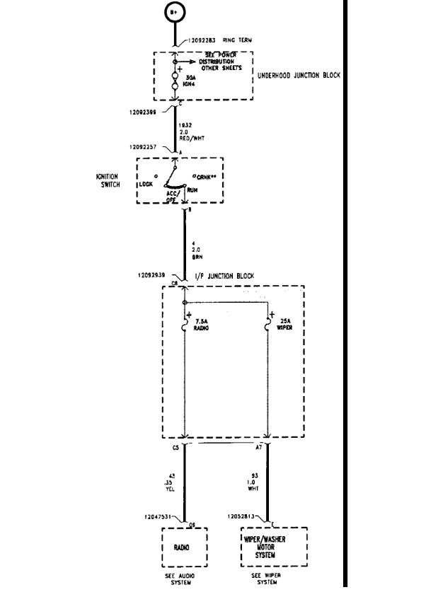

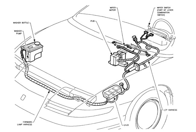

Okay, so I had a psycho cut all of my wires on the l.p. fuse box. so I was hoping that somebody would have the wire diagram for what wire goes to what.

Psycho, my favorite. Here is the wring diagrams and a guide to help you check your work:
