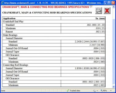

Engine Mechanical problem
1995 Saturn SC1 4 cyl Two Wheel Drive Manual
need to know what the speks for crank shaft
May 10, 2010 at 1:33 PM
SATURNTECH9
  • 30,869 POSTS
https://images.2carpros.com/forum/automotive_pictures/416332_1995_sc1_crankshaft_specs_1.jpg
there u go.
