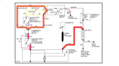

im trying to locate my starter relay for a 94 saturn sc1

If its a manual check the clutch start switch and if automatic check the neutral start switch there's no starter relay involve on both. Power comes from the ignition switch thru these switches then to the starter.
https://images.2carpros.com/forum/automotive_pictures/12900_start_circuit_saturn_1.jpg
