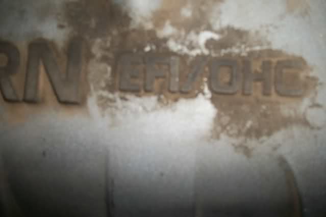

When i go to get parts for my car im always asked if its a singe or dual overhead cam. i had one fella tell me it tells you on top of the engine but here a pic so you guys can get a look at it, cause im thinking single overhead cam.

If u have a sc1 that would have a single cam.a dual cam has two humps in the valve cover and the spark plugs are in the middle of the two humps.facing straight up.a single cam the spark plugs are over by the exhaust manifold facing towards u.let me know if u have anymore questions.

ok thanks ST9, that answers my question!!
