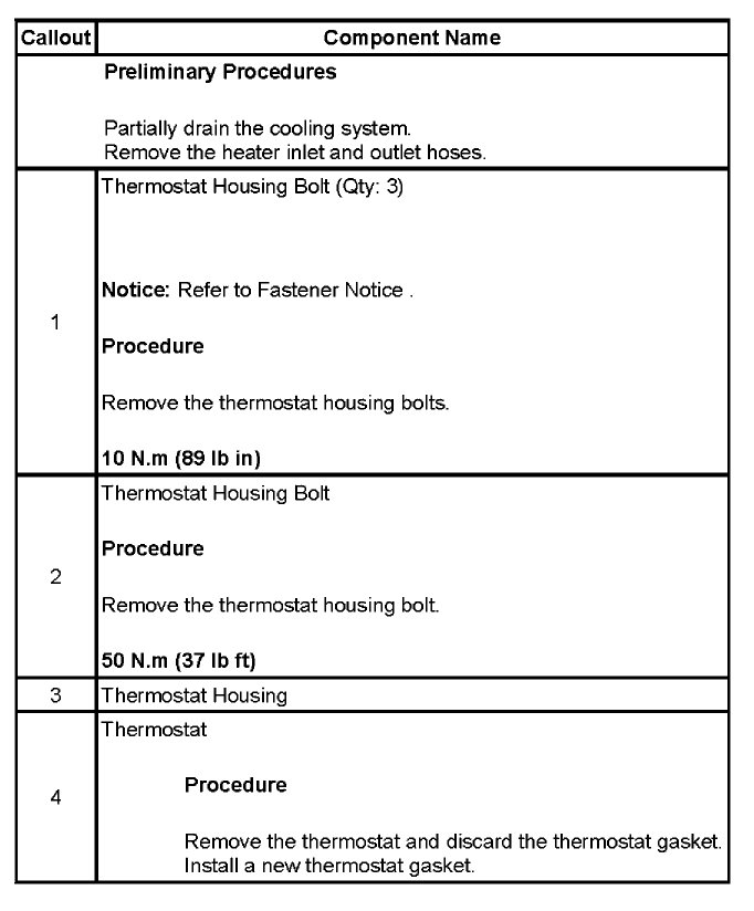

engine over heats after driving about three miles, I need to change the thermostat.
Oct 10, 2010 at 10:38 PM
BLUELIGHTNIN6
  • 16,542 POSTS

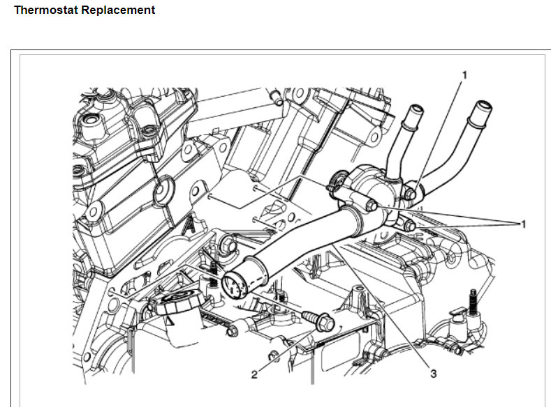

drain coolant and remove inlet and outlet hoses from housing. then remove housing bolts and housing will come off. thermostat and gasket can then be removed and replaced.
Here is a guide to show you what you are in for when doing the job with diagrams below showing how it is on your car.
