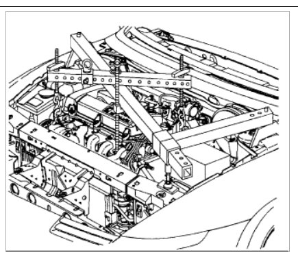

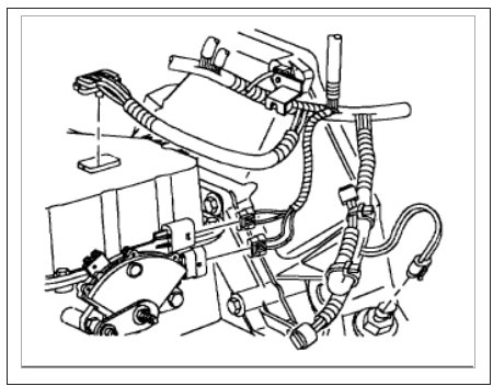

Saturn 2000 sc1 transmission reverse out had it diagnostic P7032 to replaced the first solenoid in the valve body.I did .Still not working.
Mar 11, 2018 at 10:34 AM
  • 55,423 POSTS

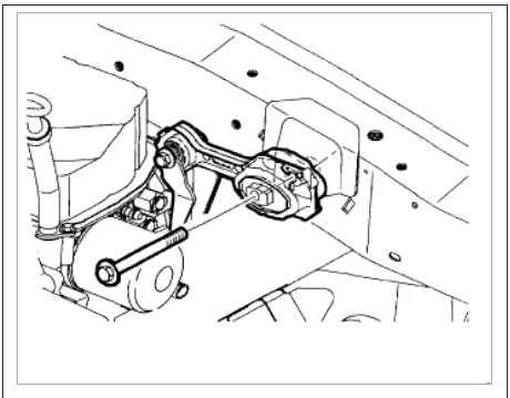

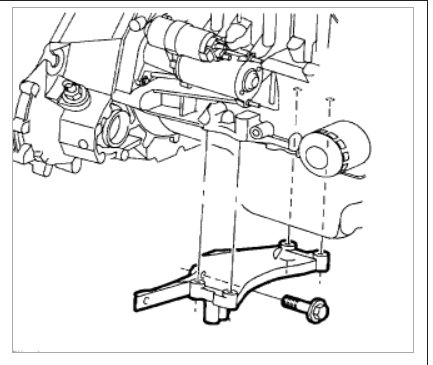

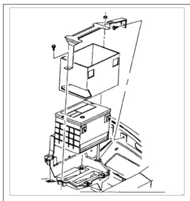

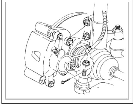

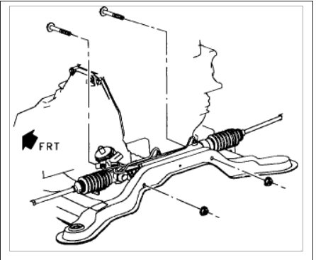

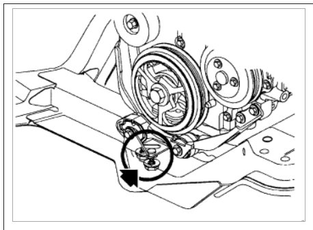

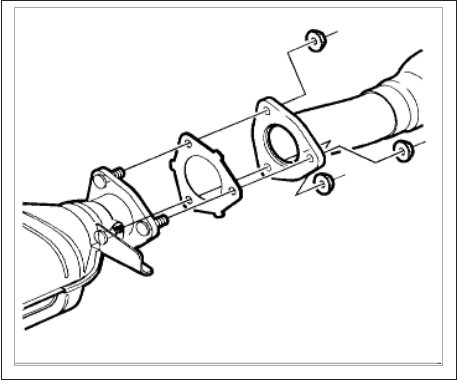

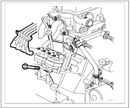

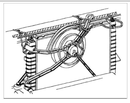

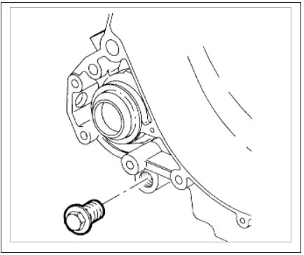

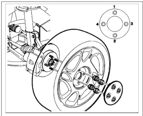

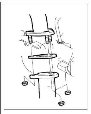

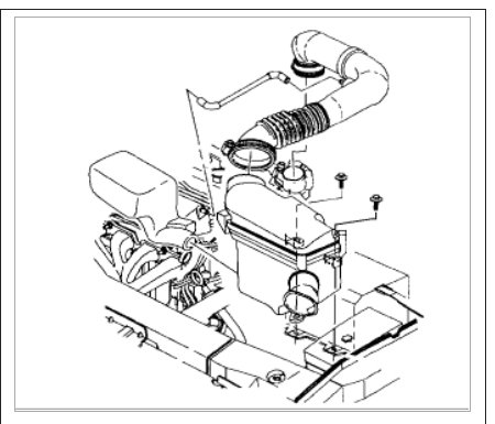

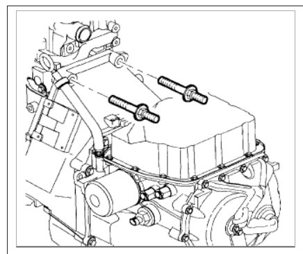

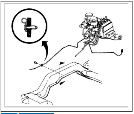

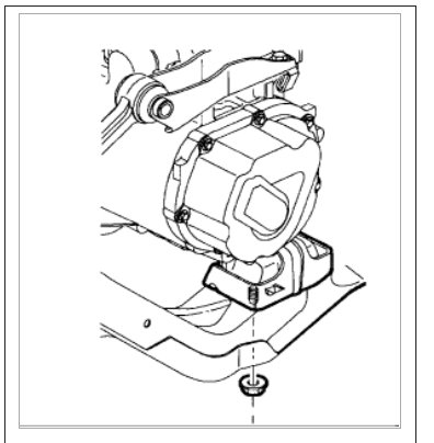

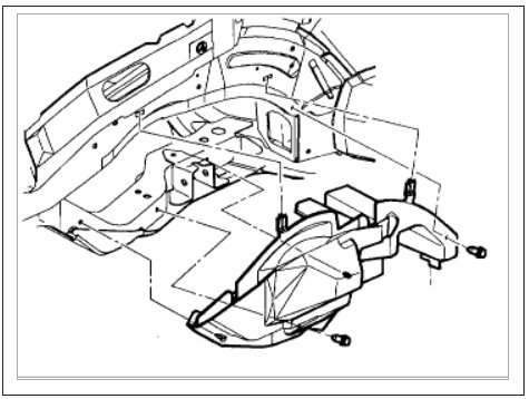

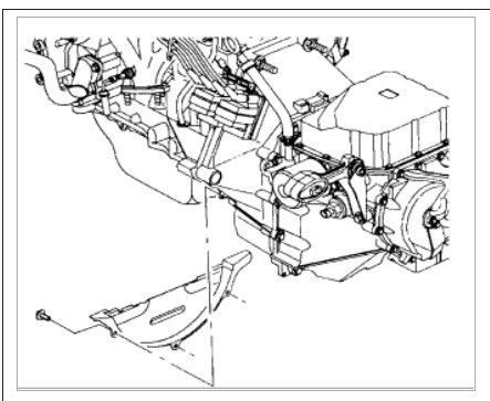

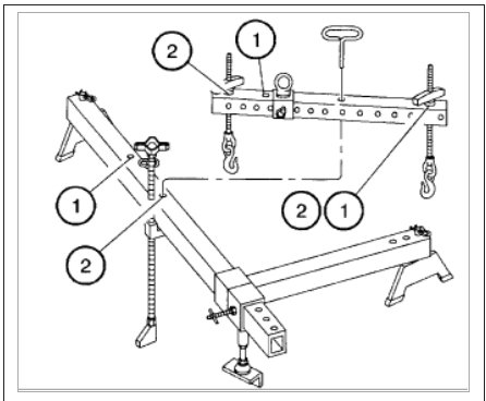

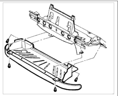

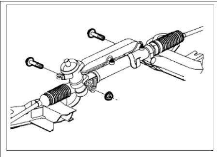

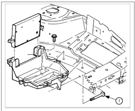

It sounds like you lost the reverse clutch pack seal which will fail to build pressure. You will need a used or rebuilt unit here is how to remove the transmission.
Mar 14, 2018 at 5:18 AM
