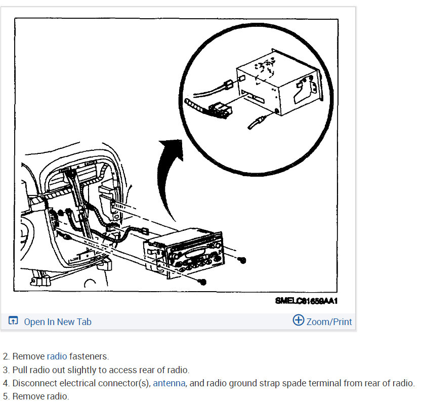

I hope someone can give me some tips? My car battery died, I got a friend to jump start my car and now the radio does not work.
I checked and replaced the fuse, still nothing. All other lights/panel indicators, etc work except the radio. There is no display, no time, etc.
Any suggestions? I have had the car jump started once before, no problem with the radio.

Sounds like the miniature fuse behind the radio is blown

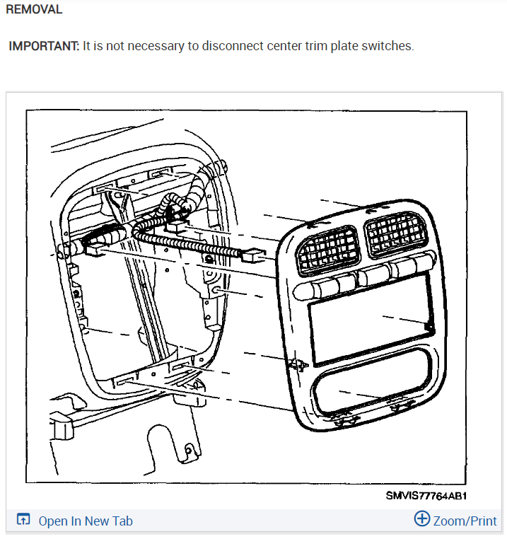

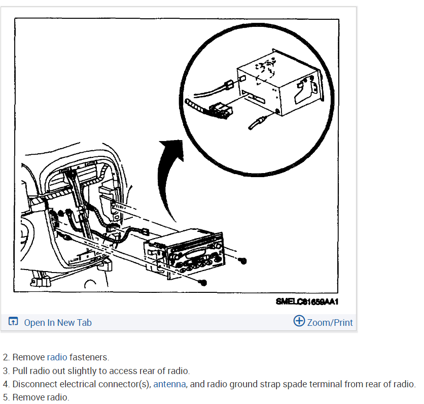

If the fuse is good the radio head unit has gone bad here is how to change it out. Check out the images (below). Let us know if you need anything else.
