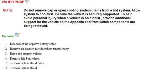

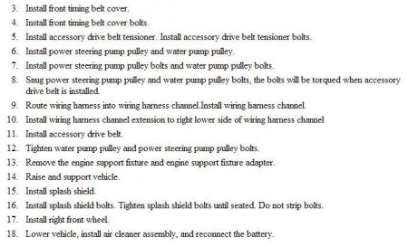

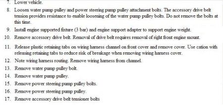

How difficult is removal of water pump on 2000 LS2 Saturn? Do I need to remove extra stuff?
