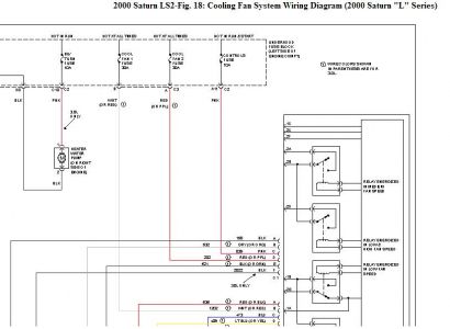

https://images.2carpros.com/forum/automotive_pictures/261618_Noname_366.jpg
Hmm looking at the wiring diagram the cooling fan module has the relays in it. The only other wires that come from the module that would have any effect for this symptom might be the fuses it leads to, pictured above

Maybe I'm looking at the wrong fuse box under the hood. You mentioned a fan module is that a differant box that maybe I'm not seeing.
Any idea what it may look like?
Mar 27, 2009 at 11:56 AM
BLUELIGHTNIN6
  • 16,542 POSTS
Yes, the cooling fan control unit is located right next to the battery, it isn't the fuse box it is an actual separate box for the cooling fans circuitry only.
