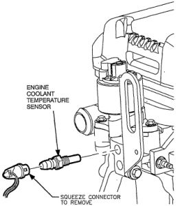

where is the sensor for the cooling fan located?

There are several different models. This is for an SC1. Please make sure to include as much info on your car as possible to ensure we provide the most accurate answer.
https://www.2carpros.com/forum/automotive_pictures/248015_1997_Saturn_cooling_sensor_1.jpg
