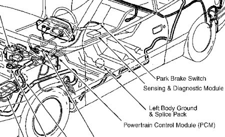

The PCM is located under the left side of the dash. PITA! The later models have them next to the battery.
Be careful when dealing with the PCM. It only takes 30 volts of static electricity to fry the PCM. It takes about 1200 volts of static electricity to make a spark if I remember correctly. Be sure to ground yourself before touching the PCM. Also be sure the battery is disconnected and the ignition is off.
Where any of the trouble codes mentioned under "Diagmnostic Aids" in my prior post ever present? Please Double check!
Check your PMs for the procedure. Be forwarned that if a short exists and is not corrected you can fry a replacement PCM. I would try a used one from a recycler myself if needed.

https://images.2carpros.com/forum/automotive_pictures/4270_99_saturn_pcm_location_1.jpg

okay, i've located what is unquestionably the PCM....but i don't know which harness to disconnect....they don't seem to be labeled, and my repair manual is zero help. lol. and no, none of those codes were mentioned, just P1635.
