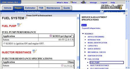

What should the fuel pressure be in a 1998 Saturn SL 2?
Jul 24, 2008 at 11:41 AM
Experienced Mechanic
75,988 POSTS
Here you go Sir
