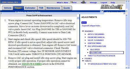

AT CURB IDLE THE TACH SHOW BETWEEN 1,000 AND 1,170 RPM. AT FREEWAY SPEED (55MPH) THE TACH IS AT 2,200 RPM. MILEAGE FOR A STRIGHT 55MPH IS BETWEEN 40 & 45MGP..
WHAT SHOULD BE;
CURB IDLE=
RPM @ 55MPH=
AND "IF" IT SHOULD BE LOWER AT EITHER/OR BOTH POINTS, WHAT CAN BE THE THINGS TO LOOK FOR.

Check your idle air control valve and throttle position sensor. See below
https://images.2carpros.com/forum/automotive_pictures/12900_idle_1.jpg
