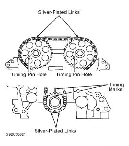

I NEED TO KNOW THE TIMING MARKS ON A 94 SATURN SL2 TWIN CAM....IF POSSIBLE PICTURES

Here is a diagram of the timing for a duel cam
https://images.2carpros.com/forum/automotive_pictures/54223_saturn_timing_chain_1.jpg
