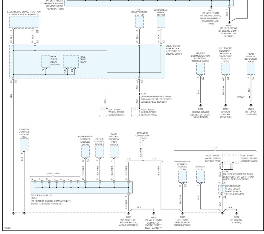

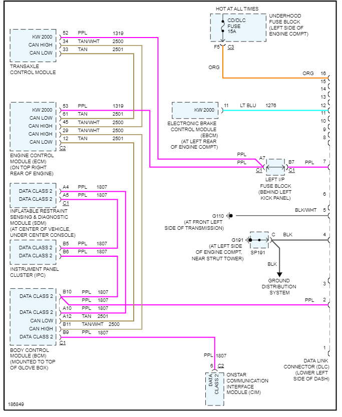

When the transmission is in park, it says it’s in 3rd gear. If i select any of the other gears, it says it’s in 3rd. It’ll only rev up to 2,000 RPMs when in neutral or park. then it starts to surge forward slowly. It’ll go forward like one foot, then stop, go forward, then stop repeatedly. It shifts hard now, and I can go forward and reverse through all the gears but have no idea what's causing it. All the fluids are good too. It gives power to the obd2 scanner but won't let me scan anything I've tried multiple scanners.
Jul 24, 2023 at 2:58 PM
  • 55,399 POSTS

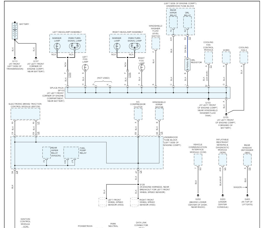

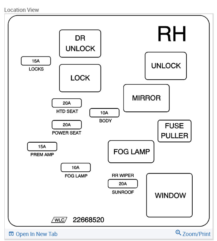

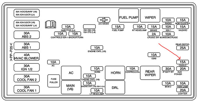

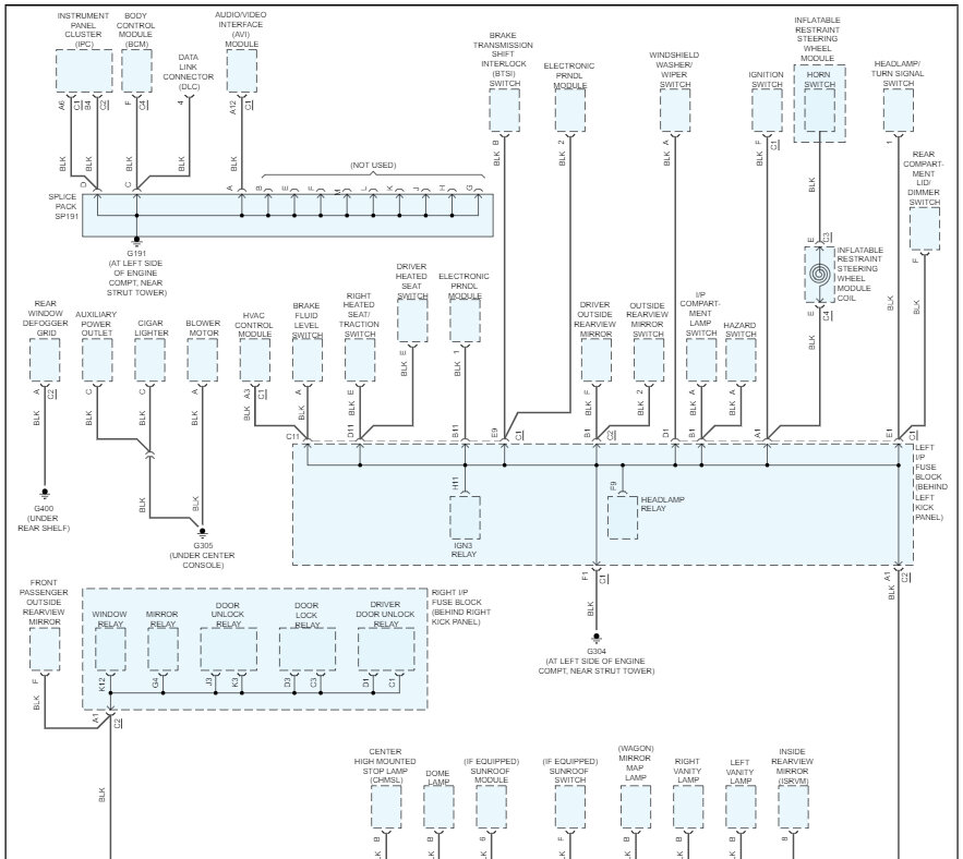

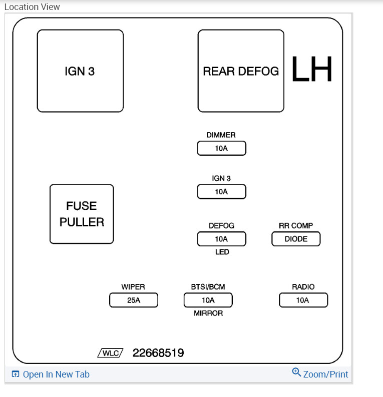

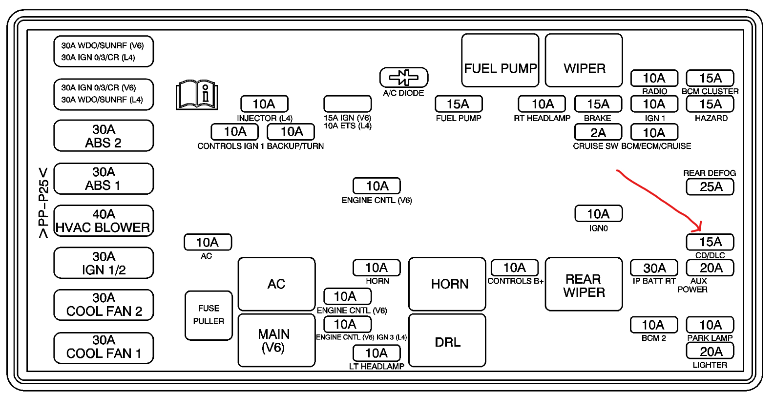

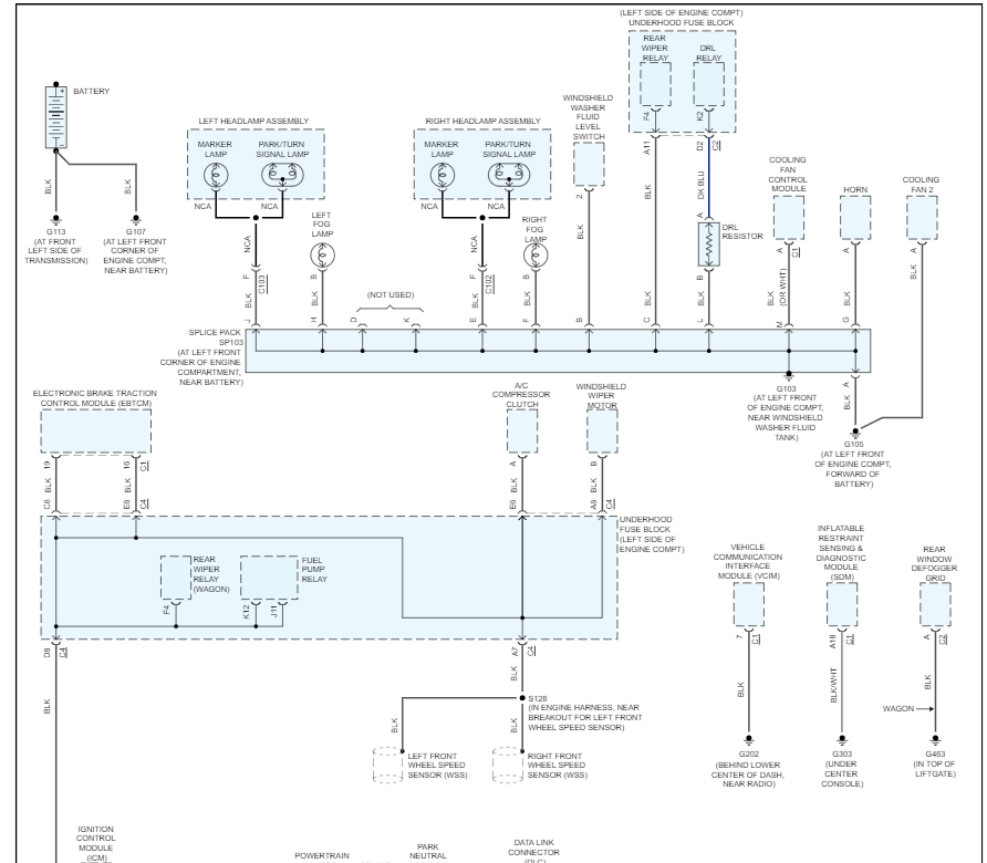

I would start by checking all fuses, especially the CD-DLC fuse in the under-hood fuse panel, left side. Here is a guide to help and the ALDL connector wiring diagrams which is what the computer uses to access the system so you can see how it works.

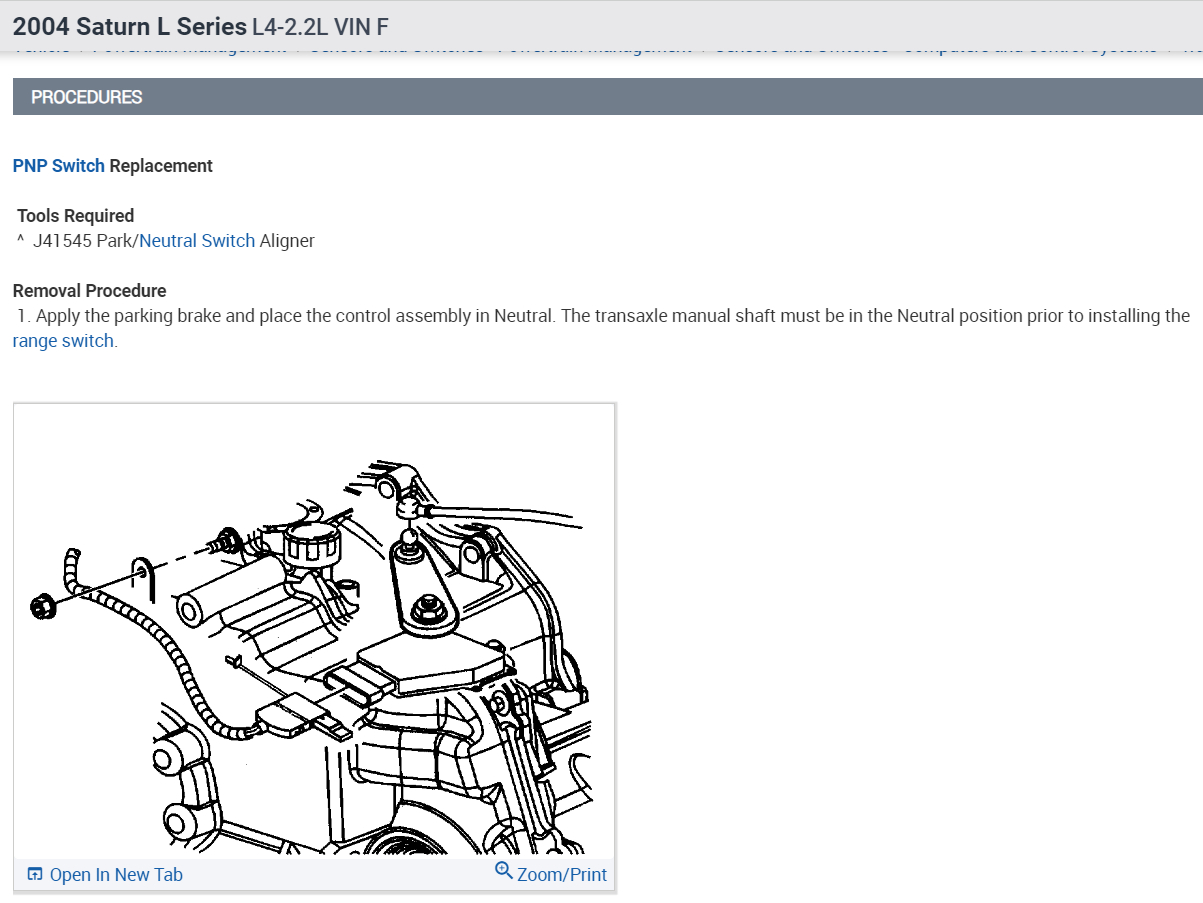

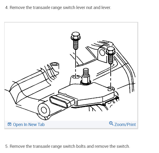

I checked all fuses already and replaced ECM, but nothing fixed it.
Jul 25, 2023 at 12:56 PM
  • 55,399 POSTS

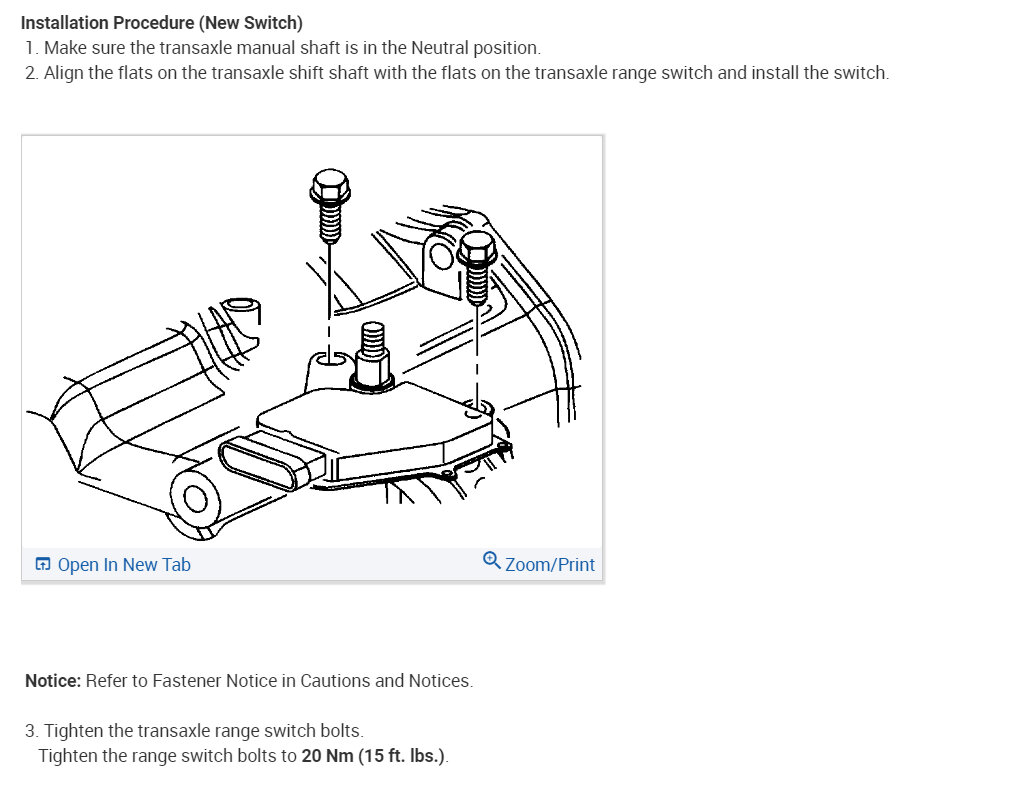

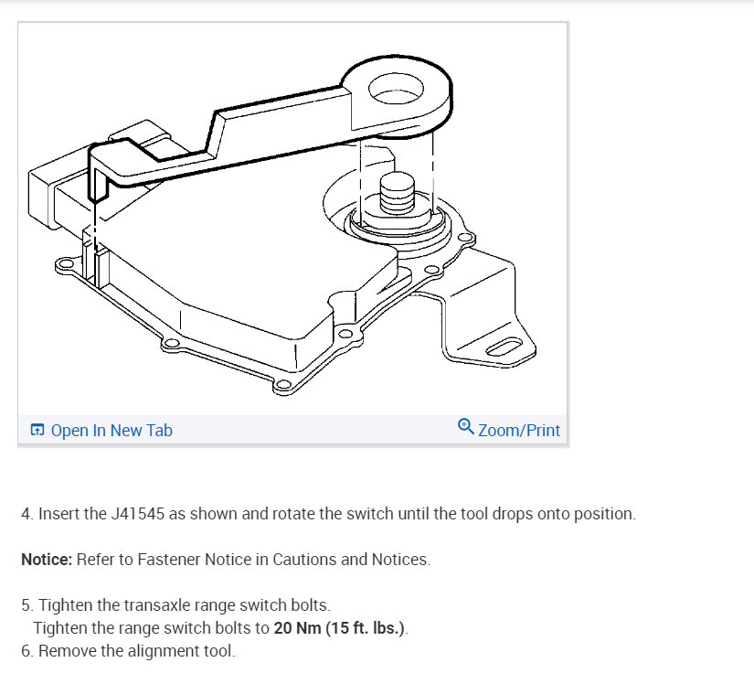

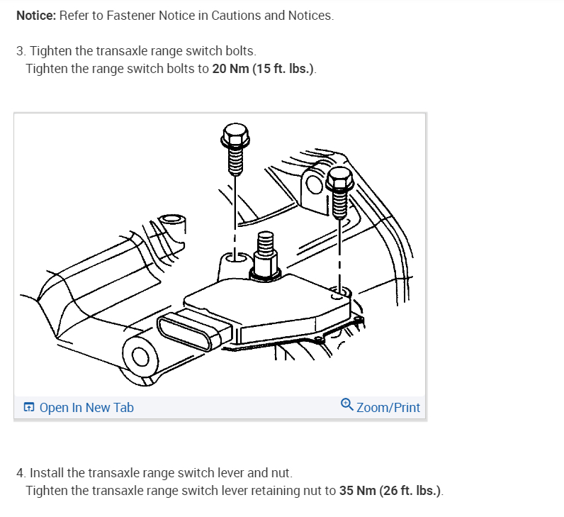

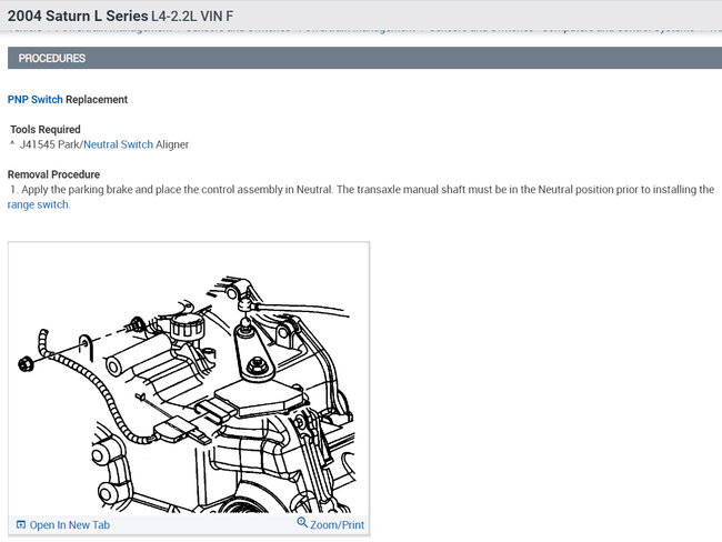

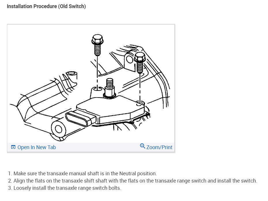

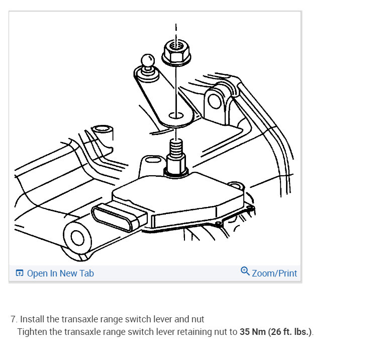

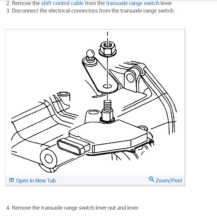

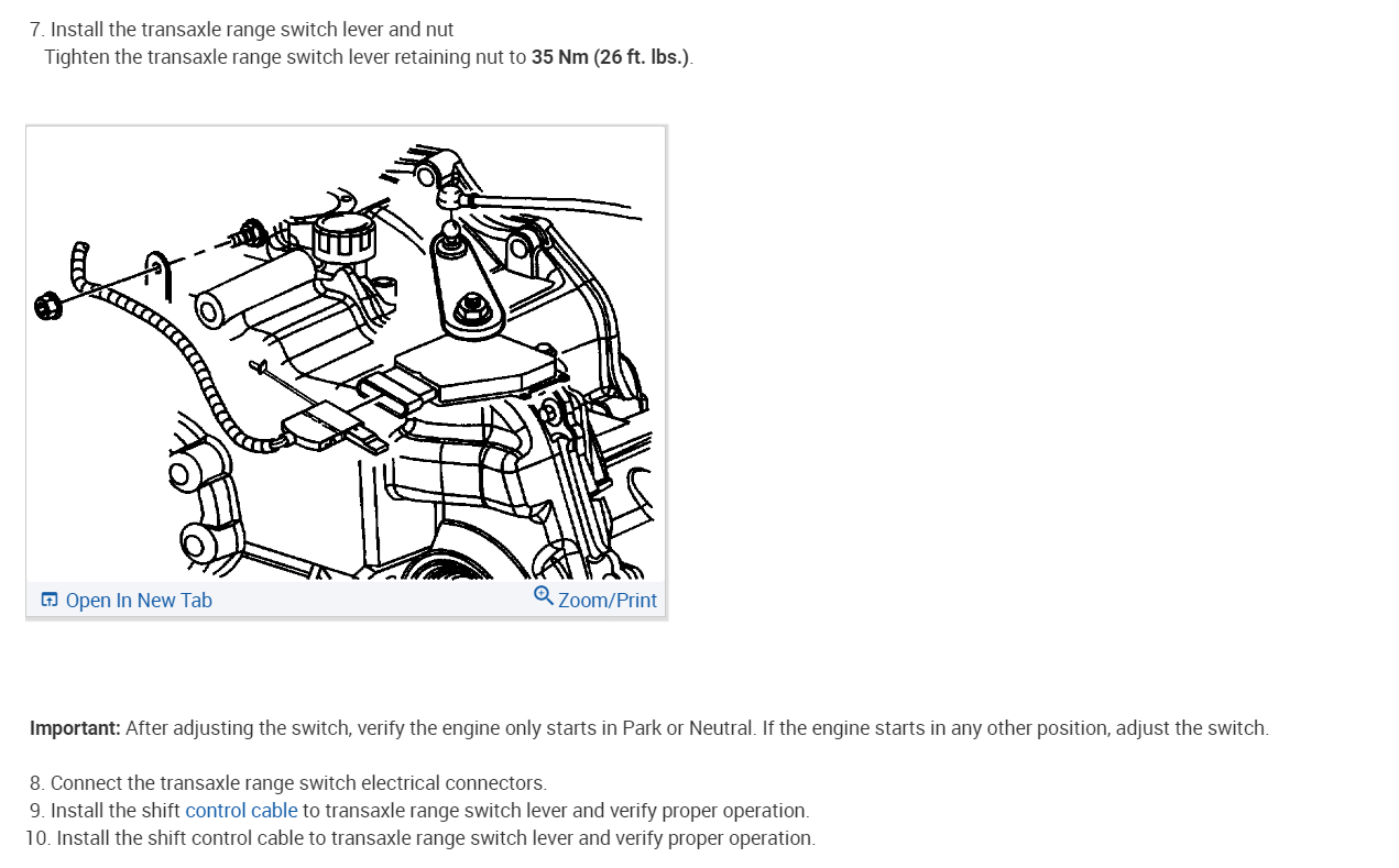

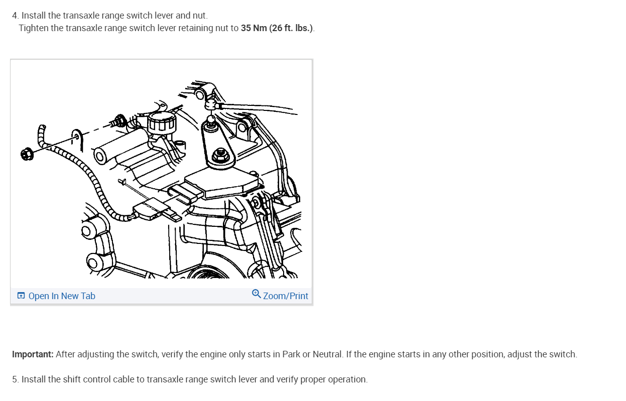

Okay, it sounds like the transmission range sensor needs to be replaced, here is the location and how to change it out. My bad I should have thought of that earlier, sorry. Check out the images (below). Please let us know what you find.
Jul 27, 2023 at 6:45 AM

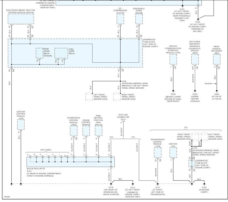

I just checked the grounds and one of the grounds we're at 8 volts instead of 12 the rest we're at 12 volts and when the key is on the on position it drops to 5 volts. Also, when messing with it when the key is on Accessories mode the transmission shows the correct gear but not in run or when running.
Jul 27, 2023 at 7:30 AM

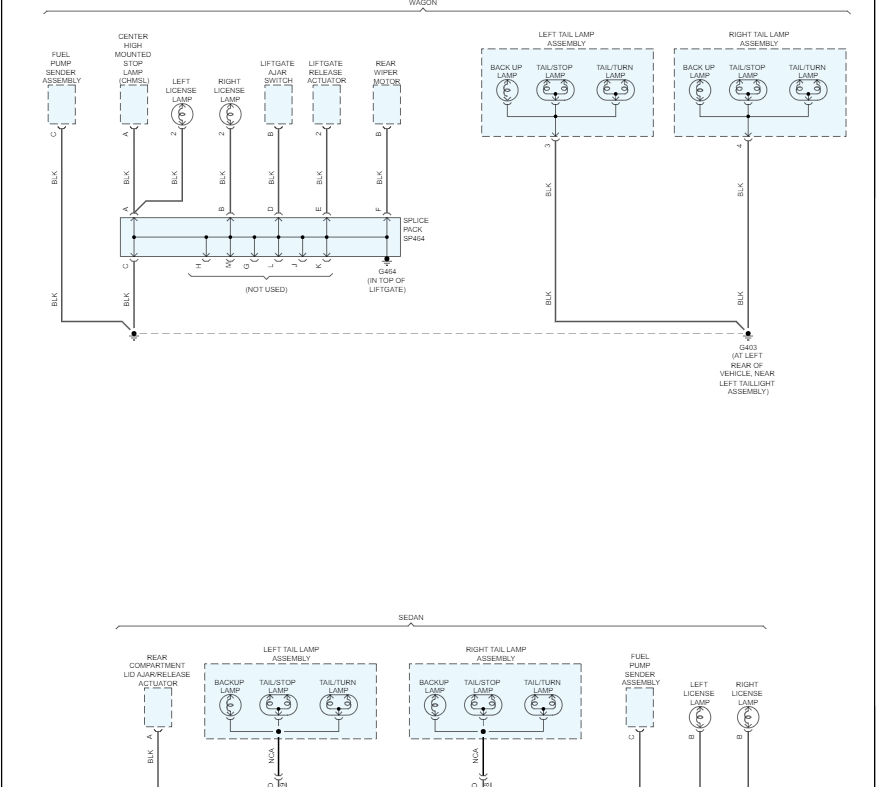

  • 55,399 POSTS

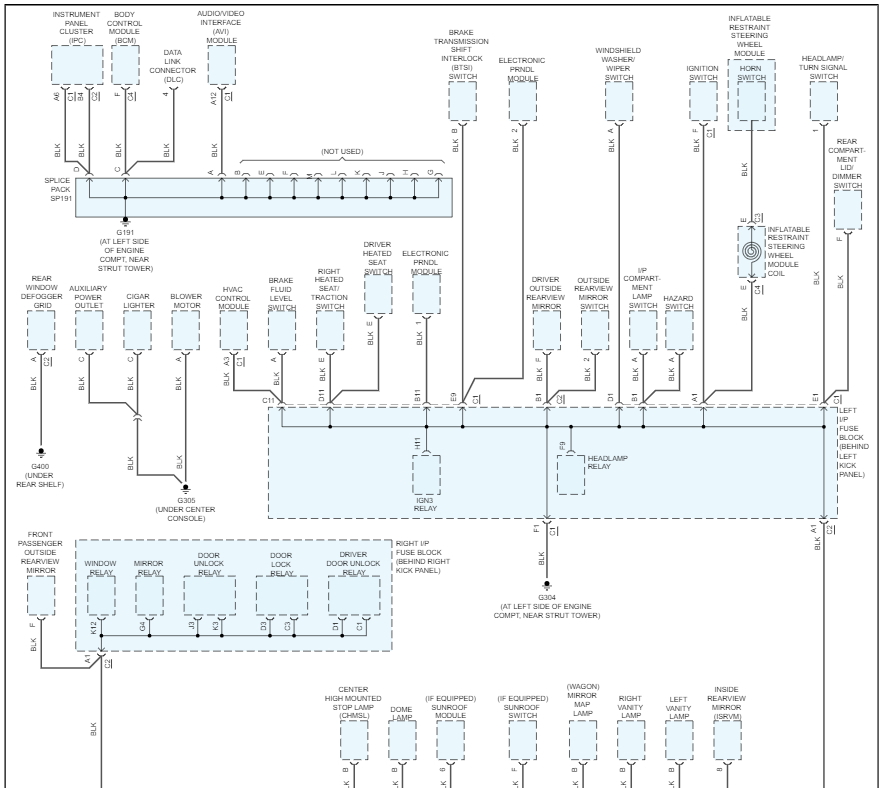

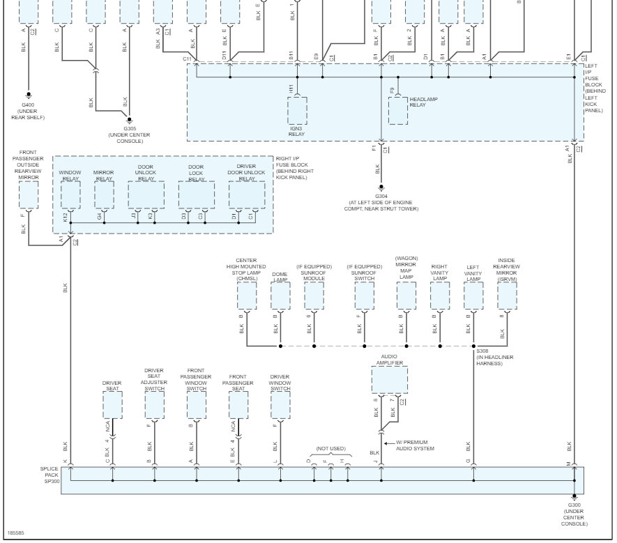

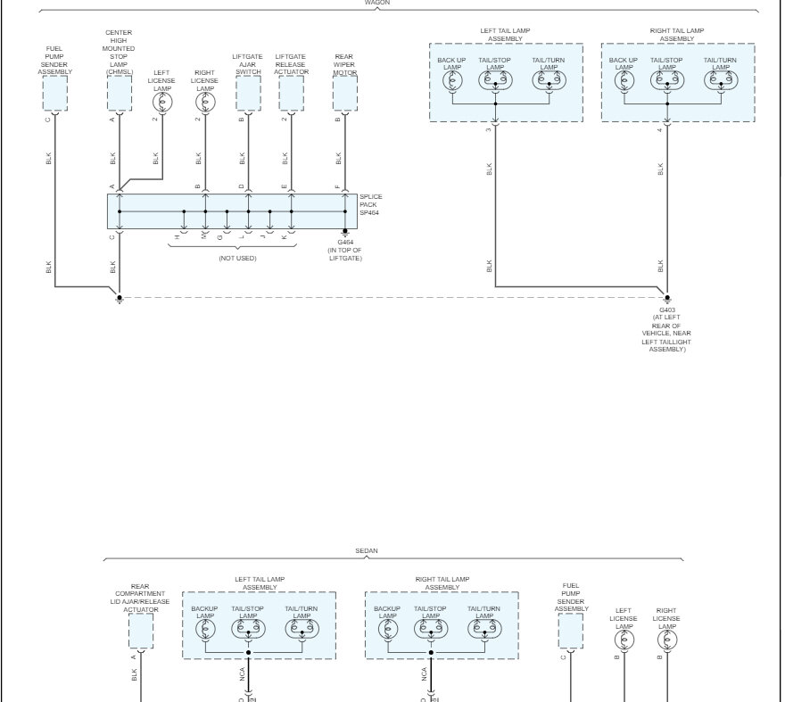

grounds are not supposed to have voltage unless the ground is bad. Can you recheck the connections to ground. Please use this guide and I have included the ground wiring diagrams so you can do the testing, all of them should have close to .0 Ohms
Check out the images (below). Please let us know how it goes.

When I checked the grounds, I set it to my voltmeter to 20 volts and connected my positive to the positive on the battery and the negative to my grounds to make sure there was power getting through.
