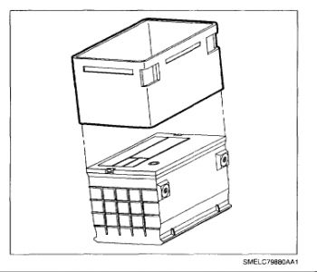

i have already unhooked the battery cables but the battery still wont pull out. How do I get it out, is there some other bracket holding it and if so where?
Tuesday, April 6th, 2010 AT 8:40 PM
  • 75,992 POSTS
REMOVAL
https://www.2carpros.com/forum/automotive_pictures/12900_b1_11.jpg
1.Disconnect negative battery cable.
2.Disconnect positive battery cable. NOTE: It is not necessary to disconnect fan control module wiring from module.
3.Remove fan control module by sliding up and off bracket. Lay module and wiring out of way.
4.Remove battery insulating cover.
5.Remove battery hold down/fan control module bracket.
CAUTION: DO NOT TIP BATTERY OVER 45 °ANGLE OR ACID COULD SPILL.
6.Remove battery.

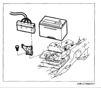

INSTALLATION
https://www.2carpros.com/forum/automotive_pictures/12900_b2_11.jpg
1.Verify battery tray is clean.
2.Install battery.
3.Install battery hold down/fan control module bracket. Torque: Battery Hold-Down Bracket: 20 N.m (15 ft-lbs) NOTE: Battery life is reduced if battery insulating cover is not used.
4.Install battery insulating cover.
5.Install fan control module by sliding down onto bracket.
6.Connect positive battery cable. Torque: Battery Terminal Bolts: 17 N.m (13 ft-lbs)
7.Connect negative battery cable. Torque: Battery Terminal Bolts: 17 N.m (13 ft-lbs)
