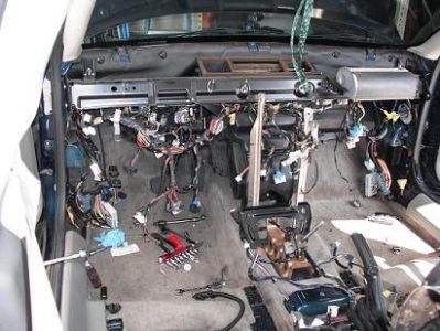

You saying "and the module that set the DTC begins communicating" in your responce has me wondering if you noted that in my orriginal post I stated there are No DTC's . I have an Actron cp9180 which includes controller area network. please read all my original post to avoid redundant info. Scan tool shows no codes & no pending codes, yet these lights persist ( SRS, ABS, & SERVICE w/wrench)
Here are some samples of yesterdays circut testing and checking
https://www.2carpros.com/forum/automotive_pictures/411145_DSCF0227_1.jpg
Everything has been re assembled

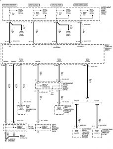

I found something interesting.
let start from the begining:
ABS,SRS, & service(wrench) are on. No DTC's stored or pending.
SRS never been deploy,ABS seem to be performing properly.there is no code for the service light.
here is my point: the problem may be in the BCM .
I'm sending the body system schematic the vehicle, and the data link connector that include the PCM.
let 's cross finger. if the light for the SRS come back after the new SRS intallation,the BCM maybe bad.
bu we must go through all the wirring from and to the BCM. I'm sending the diagram so you can look at it while we are waitting for the SRS. if you need any diagram let me know.
https://www.2carpros.com/forum/automotive_pictures/46384_pic1_2.jpg
save picture as. and zoom to see.

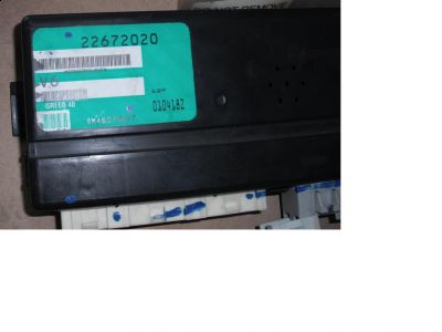

https://www.2carpros.com/forum/automotive_pictures/411145_BCMnumbers_1.jpg
Monday, September 21st, 2009 AT 9:29 PM
F15ACTACE
  • 14 POSTS
Wet, wet, wet. I found evidence that the BCM has gotten wet at some point in time.
I was unable to enlarge the diagram without distorting the text, When the image is shrunk the pixels for the writing get screwed up. See if you can send it a little larger because I do want it for referance to continue testing.

Before condamning the BCM, we should check the connection
( wire) between the BCM and the PCM.
If the BCM is or was wet, that mean moisture have got inside somewhere making damage.
The SRS light blink same as before, event the brain is not there, that tell me that the BCM is not communicating even it has power and ground.
That is my point of view.

Also the diagram you sent covers everything for the auto-doorlock system which checks out just fine.
