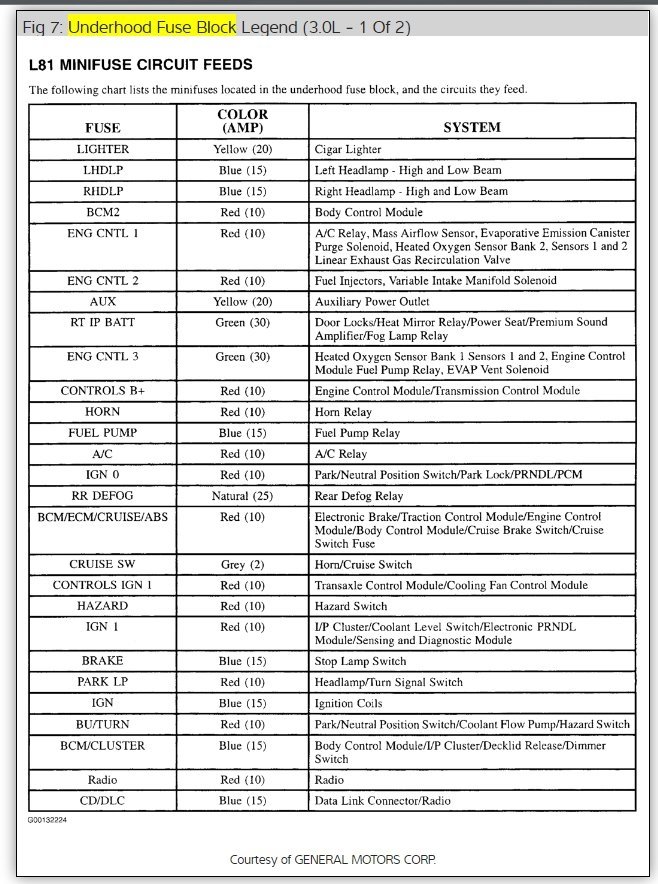

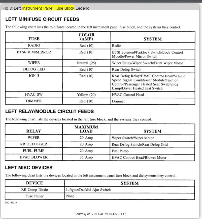

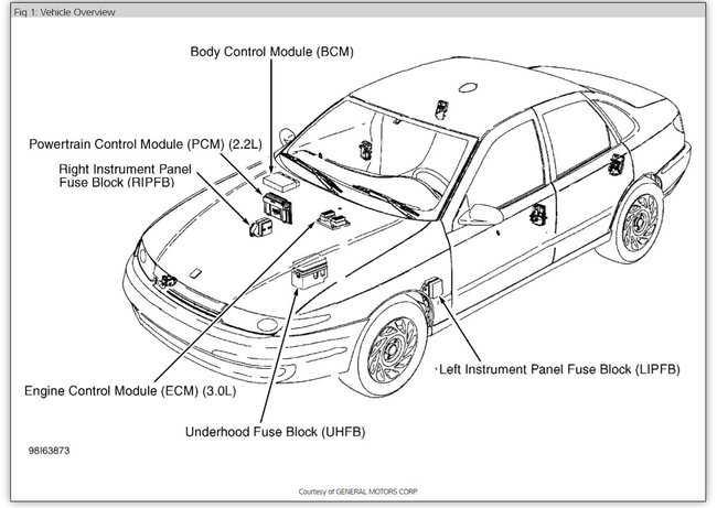

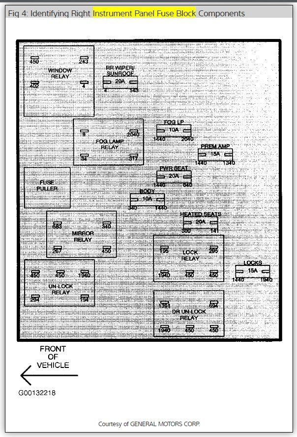

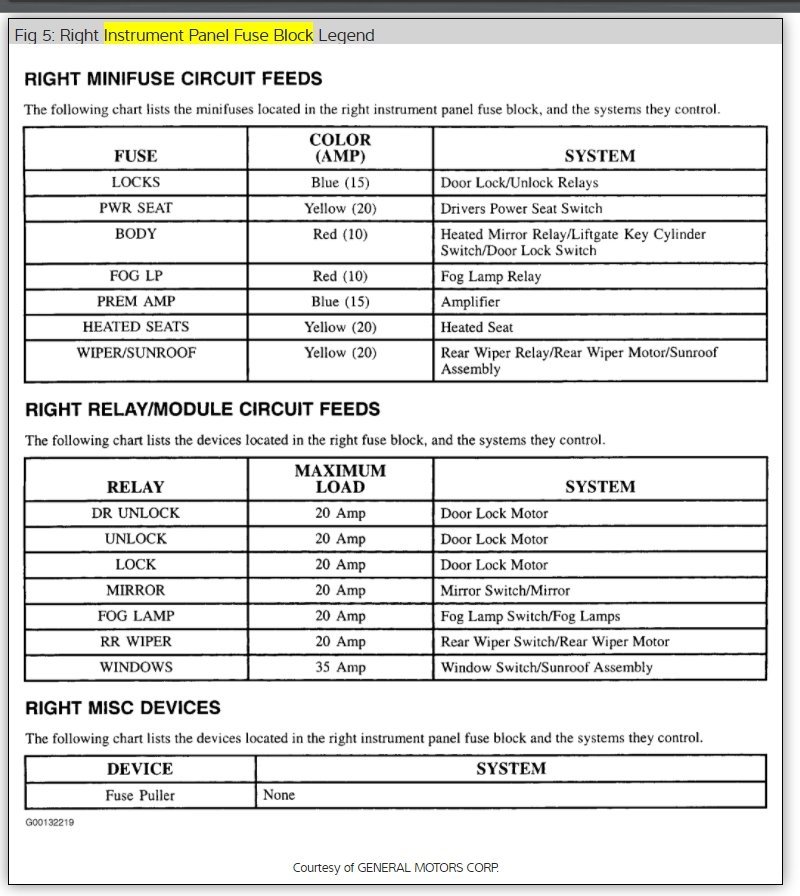

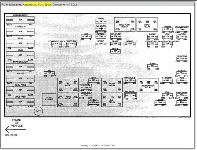

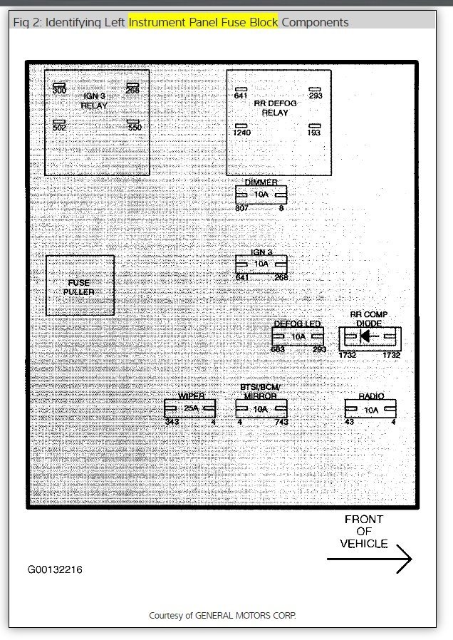

Where can I find the fuse panel layout.
2001 SATURN L300
OGIRLSX3
The door locks will not work nor will the driver side seat adjustment. The fuse panel cover on the passenger side is missing and the owners manual does not have the layout of the fuses. Where can I find the fuse panel layout.
Do you have a picture layout of the exact location of each fuse on the panel?
Where would I look to next? I have a funny feeling that the BCM may be the problem. The odometer is stuck on 694,976 miles. But everything else in the car works.
Thank you, Ken
Dec 28, 2009 at 3:11 PM
  • 54,837 POSTS

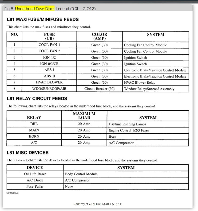

I have found the fuse and relay panel diagrams for the entire car (below) Also here are some test guide that can help you are well.
and
