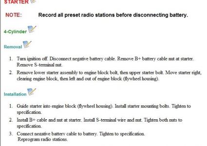

How do you change a starter on a 2003 Saturn L200?

https://images.2carpros.com/forum/automotive_pictures/261618_Noname_2112.jpg
