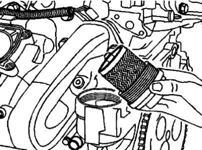

where does the oil filter go in this car

Those tricky
https://images.2carpros.com/forum/automotive_pictures/30961_einstein_4.jpg
...errr....sadistic engineers!
https://images.2carpros.com/forum/automotive_pictures/30961_oil_filter22_2.jpg
Top of the engine, look for a large plastic nut. Use a 1 3/8" socket...yeah I know it's bigger, but its a tight area and the slop lets you install and remove easily. You don't need to crank it down, snug is fine. The filter is a cartride style.
