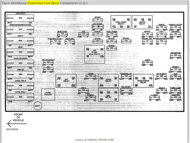

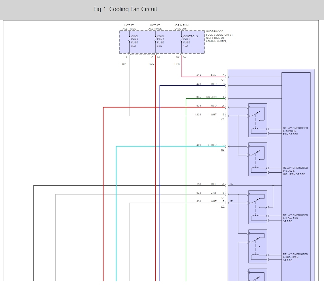

It sounds like the relay is stuck on here is the location in the diagrams below.
https://images.2carpros.com/forum/automotive_pictures/416332_2003_L200_cooling_fan_always_on_part1_1.jpg
https://images.2carpros.com/forum/automotive_pictures/416332_2003_L200_cooling_fan_always_on_part2_1.jpg
Try this first over by your battery you should see a black box that is your cooling fan relay module it has some good size wire's going to it.With the fans running and not turning off take a good size screwdriver use the handle and tap on the top of the relay module if the fans turn off you have a bad relay module.That's what usually cause's the fans to stay on.If it doesn't turn the fan's off taping on it then go have your car scanned for code's at a auto parts store like auto zone before you start the trouble tree i posted.The code's might give you a starting point.

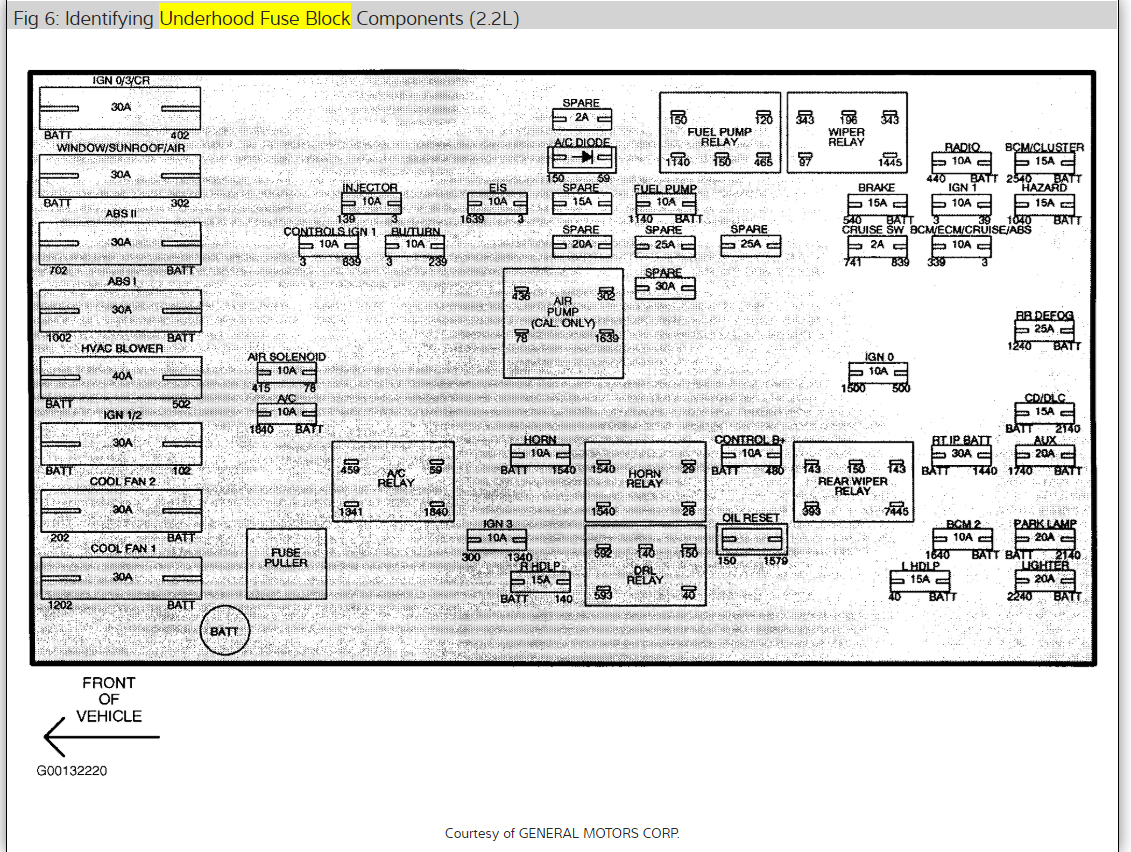

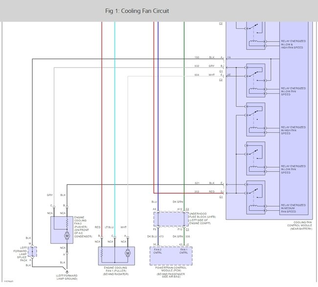

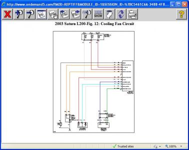

Its sounds like the fan relay is stuck and needs replacement. Here are some diagrams to help you figure out which one to replace. Turn the key on then remove the relays one at a time.

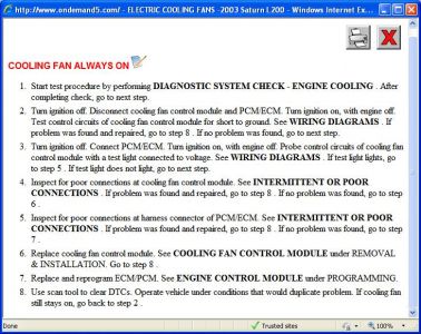

I have attached some info on the operation of the fans for your info
After you check for codes, let me know….it is possible your engine coolant temp sensor is not working correctly.
