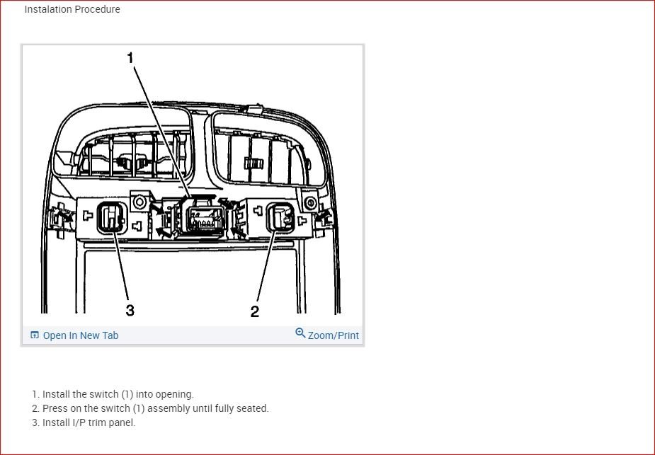

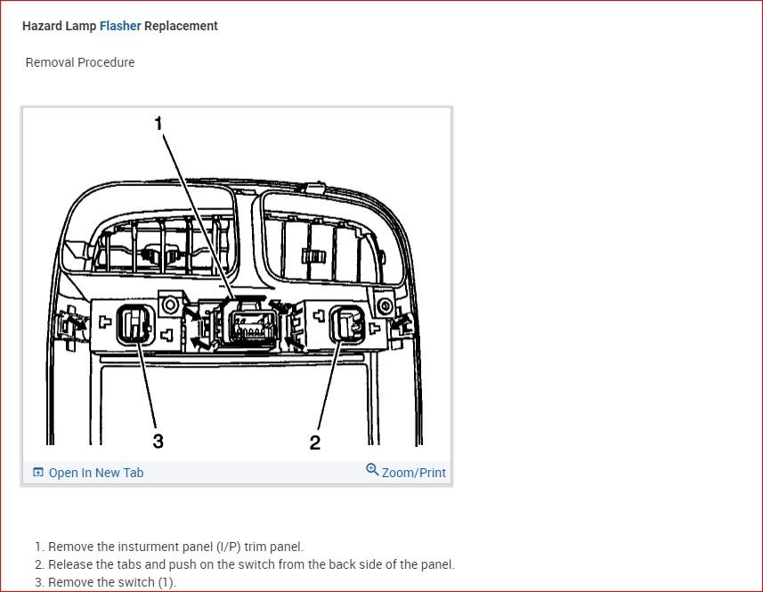

I have a 2002 Saturn L200 that I bought about a month ago. When I got it the turn signals seem to work most of the time, but every once in a while they would be on and then just shut off. I would press the hazards and they would work and then the turn signals work again. I just kind of dealt with it right now but as of today I will turn on a turn signal and it turns on but doesn't flicker or Flash. Same with the hazards. I press the button and the lights just turn on and stay on. Any idea what's causing this, or how to fix it? Hopefully cheap?
Apr 12, 2019 at 5:14 AM
Hi Heysid,
Sounds like to me that it is just the hazard flasher going bad. I would start with that, as they are pretty cheap and easy to install.
I attached the instructions on how to replace it.
Let me know if you have issues and I will see what else we can do. Thanks
