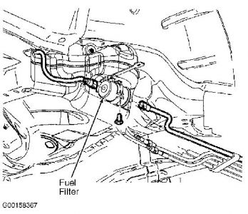

Engine Performance problem
2002 Saturn L200 4 cyl Front Wheel Drive Automatic
fuel pump location and fuel filter location

Your fuel filter is located on the underbody at the forward edge of the fuel tank (pictured below). The fuel pump is located on top of fuel tank. You must remove tank to access fuel pump module.
