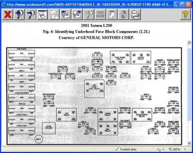

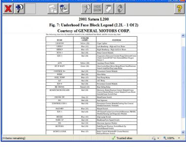

The turn signals sometimes work and sometimes dont. If i click and hold the signal bar or keep clicking it i can sometimes get it to come back on but it doesnt stay on for long. Cant find the fuse area for it. (I have 3 fuse boxes that i can see, under the hood and inside by the floor of the passenger and drivers side, but not seeing anything that says turn signals). Dont know if this has anything to do with it or not but the odometer light was out for like 3 yrs and all of a sudden it came back on and then the turn signals went.

https://images.2carpros.com/forum/automotive_pictures/416332_2001_l200_underhood_fuse_box_legend_part_1_1.jpg
https://images.2carpros.com/forum/automotive_pictures/416332_2001_l200_underhood_fuse_box_labeling_1.jpg
i posted the underhood fuse box legend part 1 that tells which fuses feed power to the turn signal circuit and the fuse labeling for the fuse box.i doubt it fuse if it was blown it wouldnt work at all not just sometimes.the most likely cause is ur flasher relay which is built into ur hazzard switch u just have pop off ur radio bezel and u can get it out.there only 22 from the dealer.when u turn on ur turn signal do u ever hear a buzzing sound from ur hazzard switch thats a sign its ur flasher.u need a new back light blub for ur odometer they burn out u hit a bump and it starts working again very common.if u want to know how to change the blub let me know.
