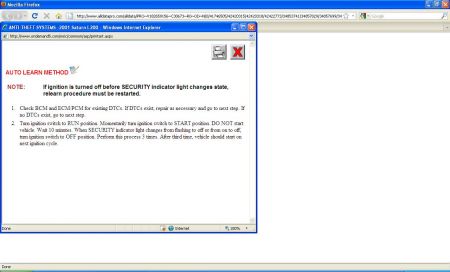

most of the time when my security light stays on o my car it won't startup....I try it an half hour later and it starts. . T[img:709aedc12f]http://www.2carpros.com/forum/automotive_pictures/576752_100514150955_1.jpg[/img:709aedc12f]his last time it hasnt started up in four days...it makes the sound like it want to start but it won't start....can you help?

https://images.2carpros.com/forum/automotive_pictures/416332_2001_L200_pass_lock_learn_1.jpg
It sound's like the reason it won't start is because you have a problem with your security system.Does everything else work like your key less entry power door lock's if you have them.Also your gas gauge etc?Try the pass lock relearn that i posted i also emailed it to you so you can read it better.

belinray say's>HOW MUCH DOES IT COST TO CHANGE OR RESET THE CODE AND IGNITION PASSLOCK SENSOR ON MY CAR INCLUDING LABOR AND PARTS.
Saturntech9 say's>Labor is 2.2hr's time's shop labor rate 80-100 per hr?The pass lock/ignition housing the pass lock sensor come's in the ignition housing i don't have a listing for a price on that you would have to shop around for a price on that.
