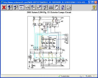

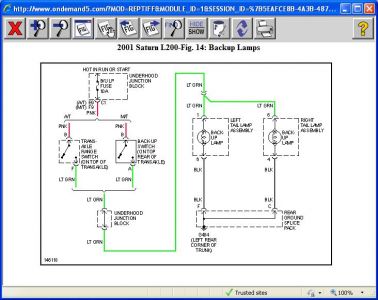

Hello My car didn't come with a manual and the directionals and the backup lights are not working and I was wondering if you could tell me where the following are located under the hood.
1. Directional light flasher location.
2. backuplight switch.
Thank you, L

Check B/Turn fuse 10amp in underhood fuse block and B/U Lp 10amp in underhood junction block.
The flasher is contain within the hazard switch and back up switch is the transaxle range switch on top of transaxle

https://images.2carpros.com/forum/automotive_pictures/416332_2001_L200_back_up_wire_diagram_1.jpg
https://images.2carpros.com/forum/automotive_pictures/416332_2001_L200_exterior_lights_wire_diagram_1.jpg
ur back up light switch is built into ur selector/neautral safety switch because u have a automatic transmission.when u look at the back up light wire diagram i posted u will see a/t which is urs and m/t which is manual transmission follow only the a/t ignore the m/t ur car doesnt have that.also i posted a exterior wire diagram for u for ur turn signals.the flasher relay is built into ur hazzard switch so to replace it u would have to replace ur hazzard button in ur radio bezel.i would start by checking all ur fuses u will see in the wire diagrams the fuses that power ur turn signal and back up lights.let me know what u find.

hi the flasher relay is above the accelerator peddle on back wall above fuse box i have 2 l200 a 1999 that has a small cable connecting flasher relay to 3 pin socket.and a 55 plate and the relay just goes straight in and dose not have a cable on it.Please this is not hard and it is not behind hazard switch.
