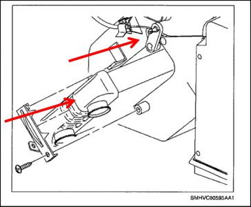

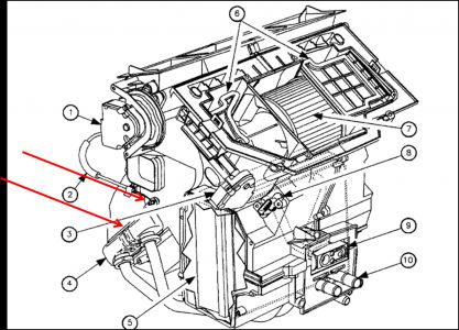

Hello -
Was the heater working fine before the core was changed?
If so, I have attached a couple of pics for you. . ..you see the heater core in the first pic. The red arrow also shows #2, the temperature cable and lever that sits right on it.
My first thought if it was working prior to the core change is this is either not hooked up or not adjusted properly.
My second pic show the entire system. . ..again, you have the heater core right there #4 when removed, the #2 temperature cable is right there and looks like it connects on to the corner.
They may not have adjusted it on installation. . ...I have attached that also.

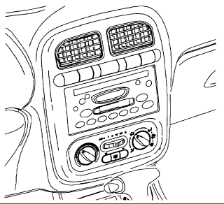

Place temperature control knob in full cold position.
Rotate temperature door lever fully forward and press cable housing into retaining clip.
Cycle control head temperature lever from full cold to full hot to verify proper operation.
Install R/H console closeout panel.

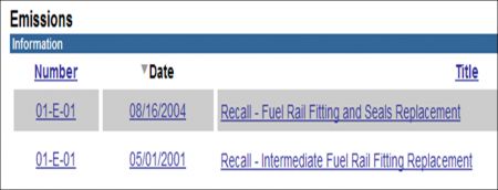

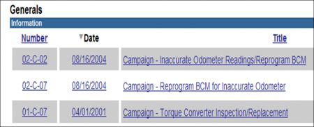

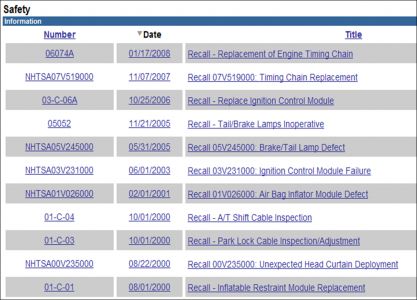

Oh. . .. . .forgot to attach. . .. . .. . .. . ..
Looks like you may have some recalls on your vehicle. The dealer may fix these for free. Please contact the dealer service department, give them the VIN number of your car and have them check on these to see if they apply to you.

I think the issue may be with the temperature cable. I adjusted it as it says and it didn't seem to help. The control knob doesn't move the temperature door lever from full cold to full hot. It goes from full cold to partial hot. If I manually open the temperature door by turning the lever by hand then the heat works great.
Would this mean the temperature control cable is bad or is there something else that would effect this?
Also, when I have the temperature control set to full hot and then shut the car off the lever drops to the full cold position and when I restart the car it stays in the full cold position until I move the control knob from the full hot to the full cold and back to the full hot.
Thursday, December 11th, 2008 AT 12:27 PM
IMPALASS
  • 3,112 POSTS
Hello -
Are you able to remove the cable and inspect both ends to see it they are connected and to see if the cable is broken or kinked?
I don't think it would be an actuator motor since it was working okay until the core change.
