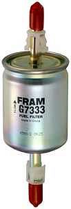

I am attempting to do some small repairs on my own. I have a 2001 Saturn L200. I want to replace the fuel filter myself. Is it difficult to do? Where is the filter located, and, are there special tools I might need to do the job?
May 11, 2009 at 3:47 PM
ZACKMAN
  • 4,202 POSTS
Fuel filter is under the car at the right front corner of the fuel tank. Fram G7333

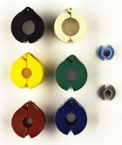

You will need this tool.
https://images.2carpros.com/forum/automotive_pictures/55316_648339_1.jpg
Well, all you need is the 5/16" fuel, but you have to purchase the entire kit for $12. The kit is good when you have to transmission or AC service
