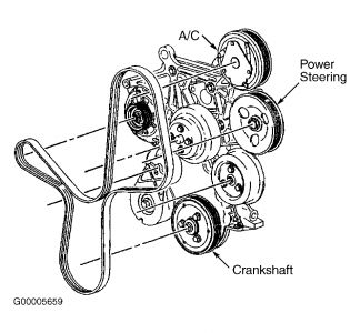

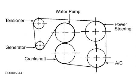

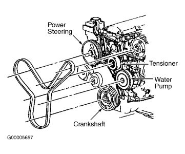

What is the drivebelt routing on 2001 L200 Saturn.
Wednesday, November 26th, 2008 AT 6:15 AM
BMRFIXIT
MECHANIC
19,053 POSTS
if none is what you are looking for check the timing belt marks link you have to enter your car info
