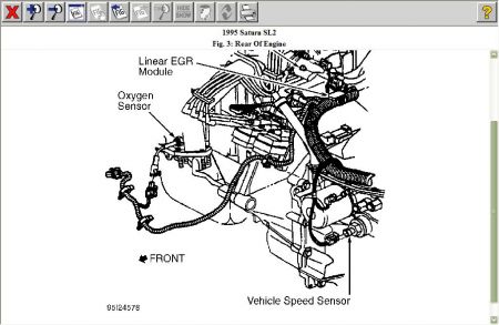

1995 Saturn L200 4 cyl Two Wheel Drive Automatic
how do you replace a speed sensor?
Jul 10, 2008 at 3:59 AM
  • 75,992 POSTS
The Vehicle speed sensor is located on right rear of engine on bellhousing-see below
