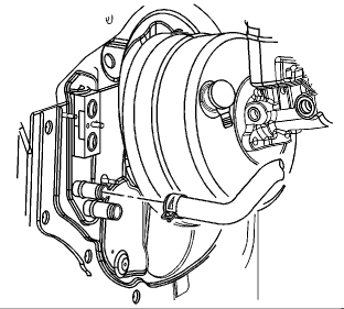

i was wondering if i could get a step by step on how to change the heater core. I have done this many times before just on older cars. The lady that i am doing this for was told that it would take 9 hours and around $1000 to repair. I am just trying to help her out because she does not have the money to get itfix by a professional.

Here is a guide to help you step by step with instructions in the diagrams below to show you how on your car. https://www.2carpros.com/articles/replace-heater-core Heater Core Replacement Tools Required *SA9111E Hose Clamp Pliers Caution: With a pressurized cooling system, the coolant temperature in the radiator can be considerably higher than the boiling point of the solution at atmospheric pressure. Removal of the surge tank cap, while the cooling system is hot and under high pressure, causes the solution to boil instantaneously with explosive force. This will cause the solution to spew out over the engine, the fenders, and the person removing the cap. Serious bodily injury may result . Removal Procedure
https://images.2carpros.com/forum/automotive_pictures/12900_hc1_1.jpg

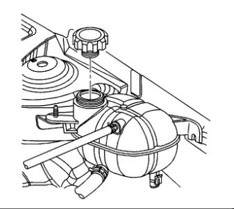

1.Remove the surge tank cap. 2.Raise and support the vehicle. Refer to Vehicle Lifting.

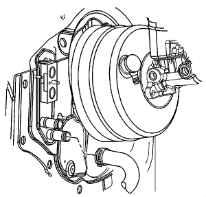

7.Reposition the heater outlet hose clamp at the heater core using SA9111E.

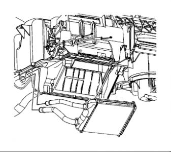

8.Remove the heater outlet hose from the heater core. 9.Reposition the heater inlet hose clamp at the heater core using SA9111E. 10.Remove the heater inlet hose from the heater core. 11.Remove the heater core cover.

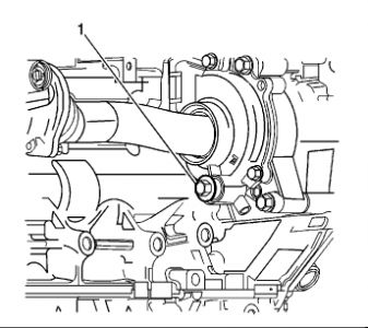

12.Remove the heater core. Installation Procedure
