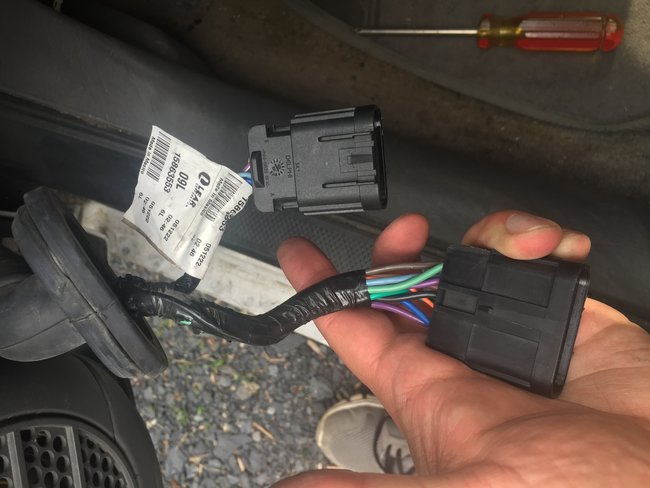

I have the same issue. The windows work after moving wires around or when door is partially open. I have been looking for the replacement wires for a few months now with no luck. Any suggestions?
2006 Saturn Ion SL2
