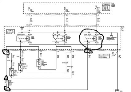

Driver side power door lock will not work, all other doors work fine. Replaced lock actuator, but no luck. Any suggestions? Thanks, Paul
Jan 11, 2010 at 9:32 AM
MATHIASO
  • 1,209 POSTS
Hello PAULW155 Welcome to 2carpros.com In the fuse block, the first relay is the driver door unlock relay.check it. if the relay is good, check the TN wire from the relay to the driver door lock actuator for open. if the wire is good, check the GY wire from the driver lock actuator to the module for open. (check your email for diagram)

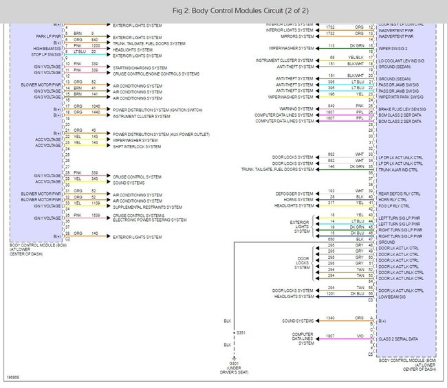

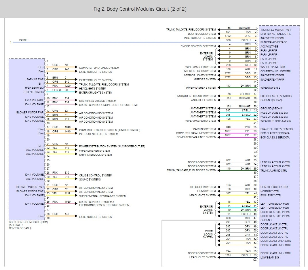

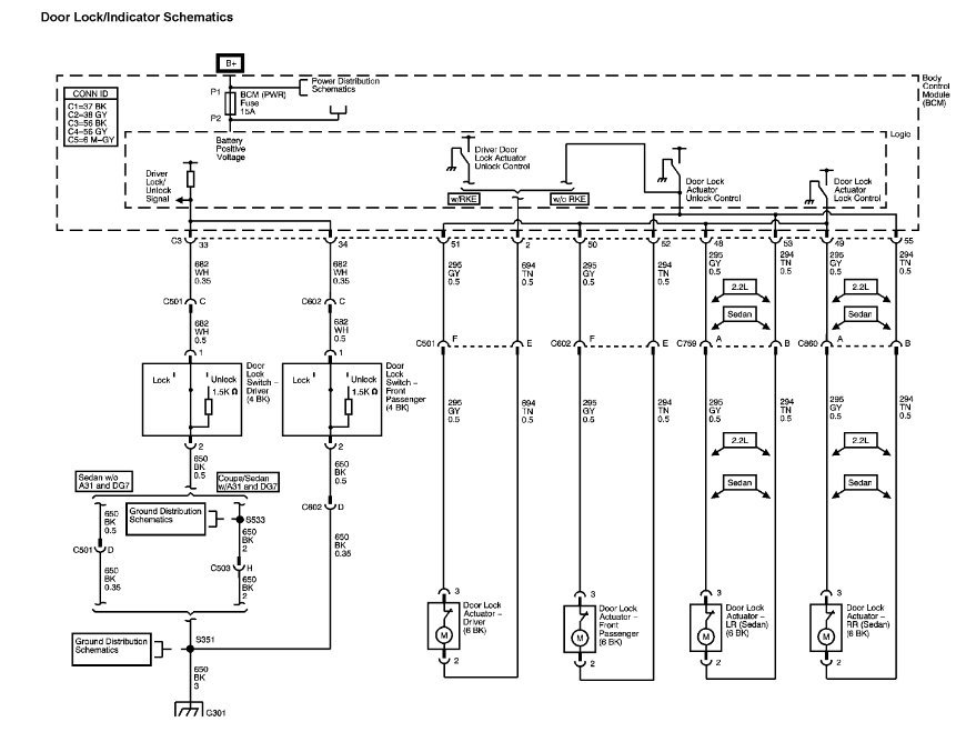

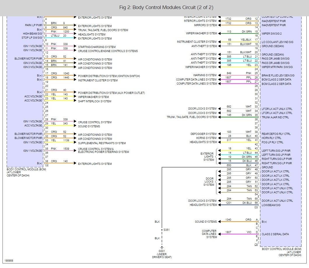

Hey guys,
Just found this thread and am going to try and help, here is the wiring diagram for the locks and the related BCM wiring. Use a test light to see if the lock actuator is getting signal or if it is a bad ground issue such as a broken wire in the door which is common.
Test the ground of the actuator while working the door lock if it lights up the ground is bad.
Please run some tests and get back to us so we can continue helping you.
Best, Ken
