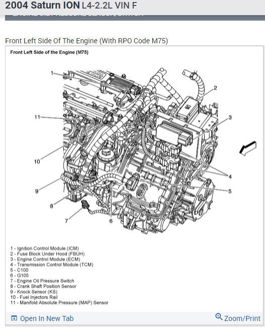

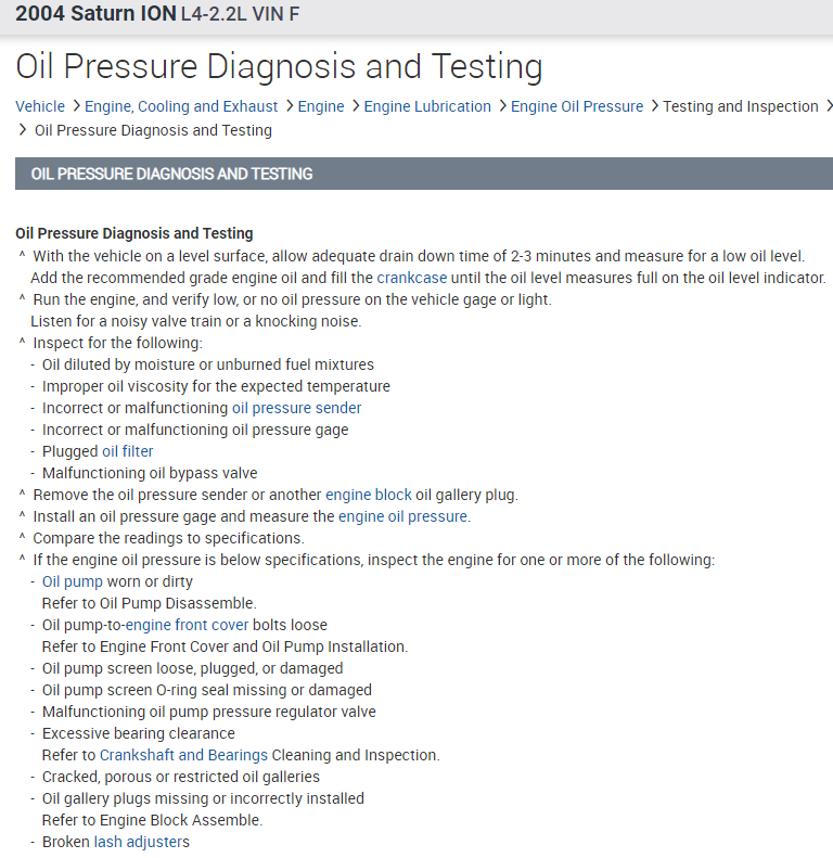

my 2004 saturn ion do not have any oil pressure. I was driving and the battery light and oil light came on together. I changed the battery, but still no oil pressure.

Does the vehicle cranks over?
Sometimes the oil pressure light can come on due to a bas pressure sensor.

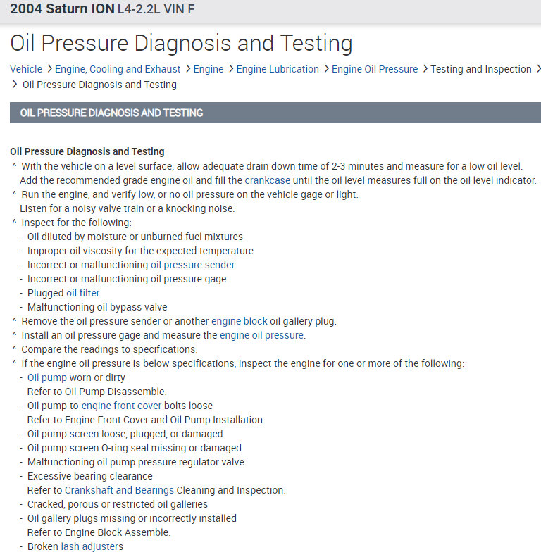

Here is a helpful article on low oil pressure:
https://www.2carpros.com/articles/high-or-low-engine-oil-pressure

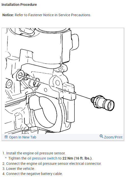

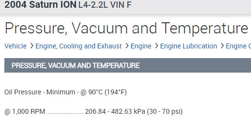

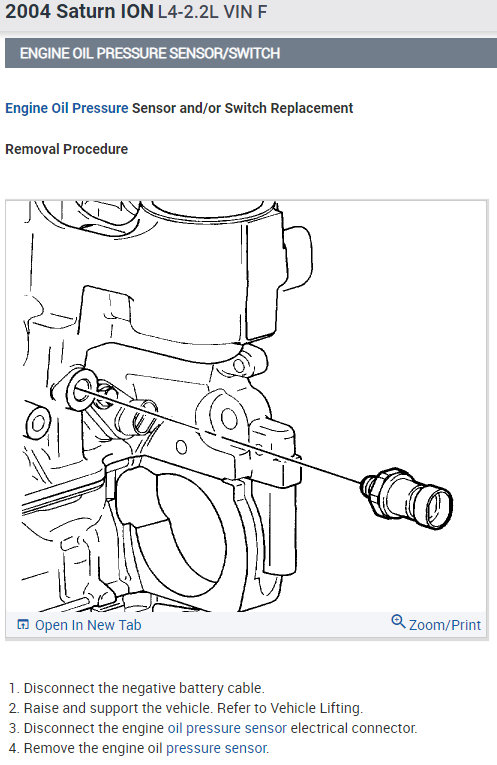

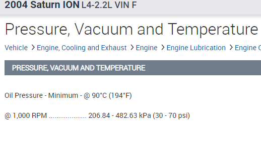

I have attached a guide to diagnose oil pressure issue. Also included the pressure sensor replacement procedure.
