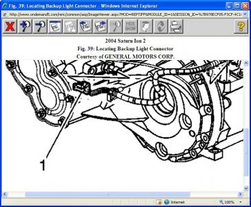

FELDMAN78
Could you tell me where the back up light switch is located?
May 24, 2020 at 1:41 PM (Merged)
SATURNTECH9
  • 30,869 POSTS
https://images.2carpros.com/forum/automotive_pictures/416332_2003_ion_back_up_light_switch_1.jpg
The number one connector in the diagram plug's into the back up light switch.
FELDMAN78
Thank you for the picture. This is located on the front driver side behind tire?
SATURNTECH9
  • 30,869 POSTS
Yes it's behind the drivers side tire area turn the key to the run postion with the engine not running unplug the back up switch jump the connector that goes to back up switch across the two terminals.The back up lights should come on if they do but don't with the connector plugged in and the car in reverse then you have a bad back up light switch.I have seen a lot of back up light switches on those.
