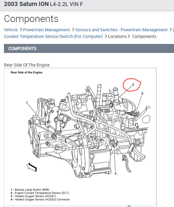

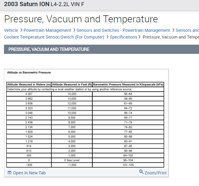

where is the coolant temperature sensor?

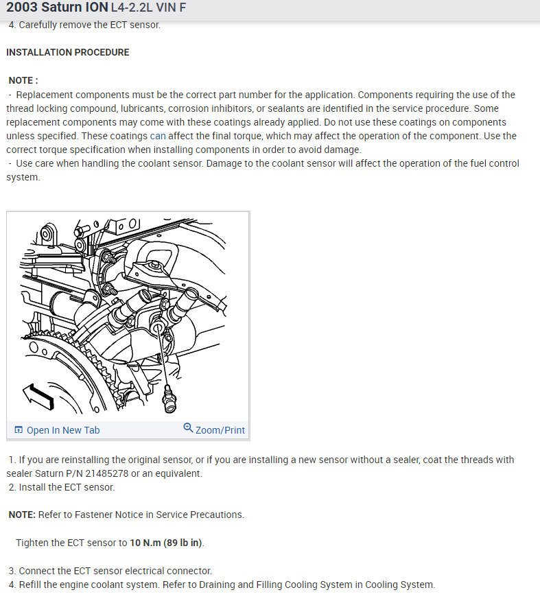

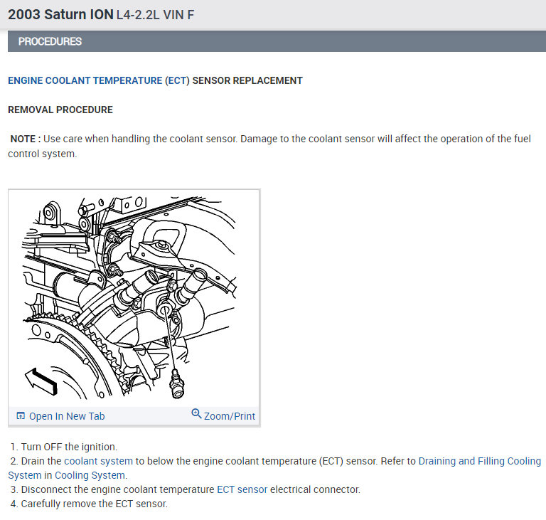

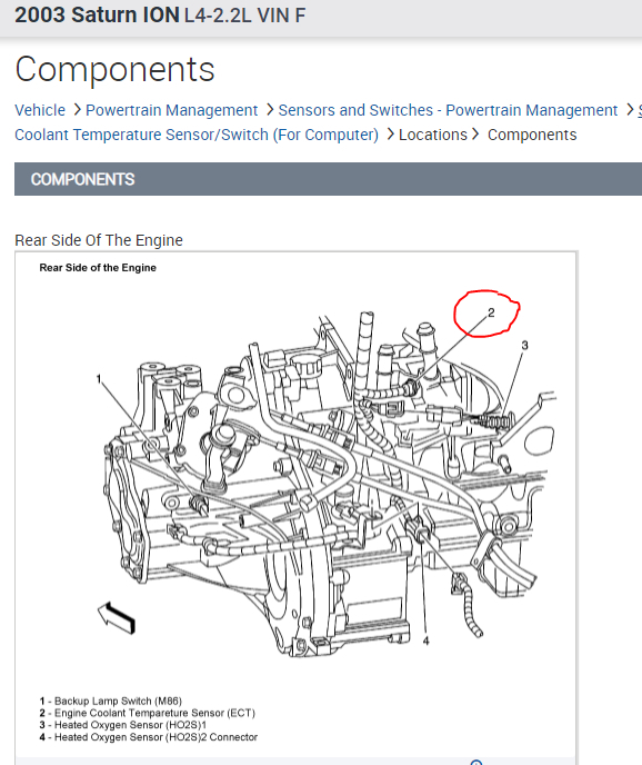

The coolant temperature sensor is located on the rear side of the engine (see diagram below).
Replacement of the sensor is simple. Just unplug the harness and unscrew the sensor from the engine.
Remember to only work on the cooling system when the engine is cool.
Here are couple of articles that you might find helpful:
https://www.2carpros.com/articles/how-a-coolant-temperature-sensor-works
https://www.2carpros.com/articles/coolant-temperature-sensor-cts-replacement
I have attached the replacement procedure for this sensor as well.
