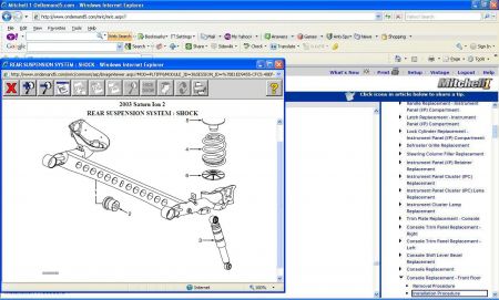

I had new shocks and springs installed in the back. When, I hit a bad bump or pot hole, it's like the back tires are flat. Thank You!! Richard

https://images.2carpros.com/forum/automotive_pictures/416332_2003_ion_rear_suspension_1.jpg
Those are good shock's but shock's only smooth out the bounce of the car.The coil spring's hold the weight of the car up and prevent bottoming out.You said you changed your coil spring's too did you get saturn one's or aftermarket one's?Let me know also you never said why you replaced the spring's and shock's?Was it bottoming out before you changed everything?Or did all this start after you changed everything?

Iam not sure who make's the Saturn spring's when I got Saturn part's to put on the car's most of the label's just say Saturn and the part's aren't marked.I don't know the difference between the Saturn rear spring's and the aftermarket one's I have never even seen a aftermarket spring.I spent all my year's working at the Saturn dealer's So I dealt 99 percent of the time with the factory part's.I have never even had to replace a rear coil spring on those car's for colasping and causing the car to bottom out.There's really no weight back there to cause them to colaspe.The only time I have seen people bottom those car's out is when they went too fast thru a dip or a pot hole.Let me ask you this is your tire's leaving a mark on your inner fender liner's from bottoming out?When people bottom there car's out the tire's alway's leave a mark there.The wheel's have alot of room to travel before they bottom out as you can see from the distance from the tire's to the inner wheel liner.Let me know.

If you put the bigger tire's on it will make your speedometer off and not read the correct speed.Now on your tire's not absorbing the bump's in the road it's hard to say on that one since i can't test drive the car to see what's it's doing.I can tell you this though there isn't much in the rear end you haven't replaced that would affect your ride.IT's just the i beam the spring's and the shock's.
