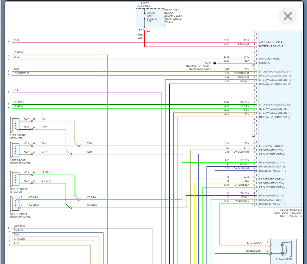

There is no sound in my car. Radio does not come on at all. My blinker blinks but does not make the clicking sound. It was working at one time. Everything just stopped working one day. The warning sounds don't even sound.
Jan 2, 2010 at 2:29 PM
  • CAR REPAIR CONTRIBUTOR

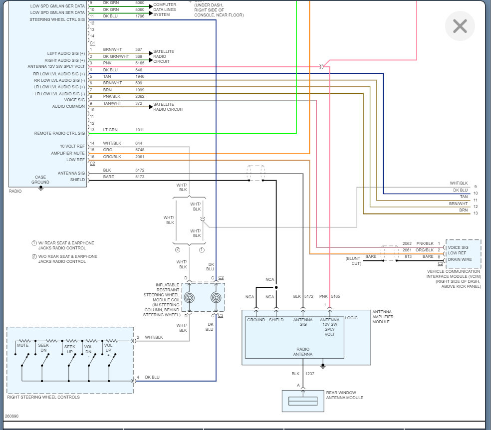

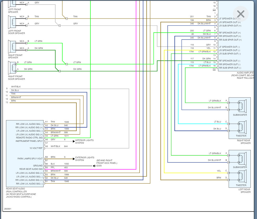

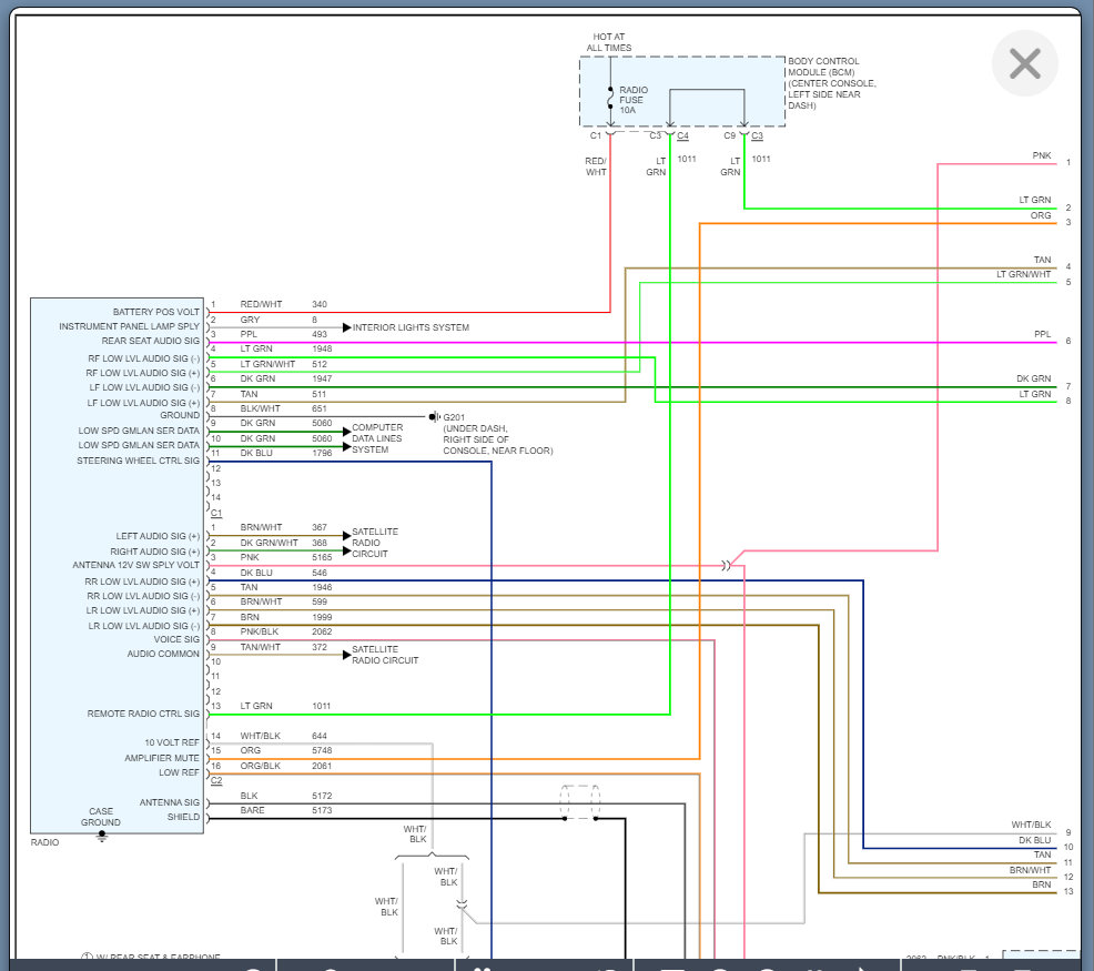

These could be a couple of things, but we need to start with checking the power to the radio and make sure it is getting power on the proper fuses.
Then we need to follow the power through to the amp and make sure that it is okay as well.
The most likely cause is the amp if all power is correct so I am going to suggest we start with looking at the radio circuits and if we fix that, I am sure we will fix all the issues.
Take a look at the wiring diagram below and let me know what you find.
Thanks

I took it to a shop. I guess the radio was just faulty so we have to replace the radio.

had the radio installed today and it worked, and it fixed the blinker sound and the other car noises too. :) So, the problem was a faulty radio. Thanks for your help and trying to solve this problem.
