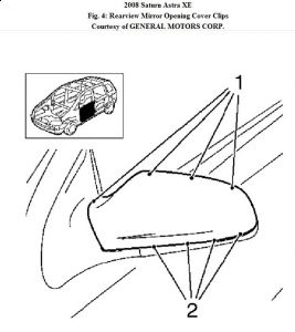

subject line says it all .. How do I remove it ??

Hi dx7keys, Here are the removal procedures. OUTSIDE REARVIEW MIRROR OPENING COVER REPLACEMENT Removal Procedure
https://images.2carpros.com/forum/automotive_pictures/192750_RearViewMirror08AstraGif04_1.jpg
1. Remove the rearview mirror opening cover. 2. Loosen the 4 top clips (1). 3. Release the 4 lower clips (2). Installation Procedure Install the rearview mirror opening cover. "¢ Install the 4 lower clips. "¢ Install the 4 top clips.

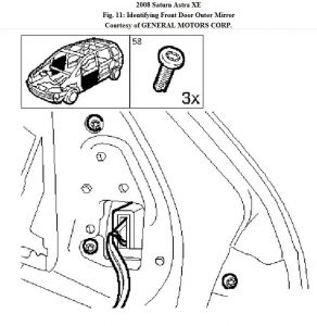

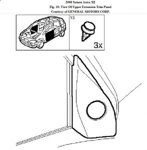

I need to remove the entire mirror housing from the auto ..

Sorry for the misunderstanding. POWER MIRROR REPLACEMENT Removal Procedure
https://images.2carpros.com/forum/automotive_pictures/192750_RearViewMirror08AstraFig10_1.jpg
1. Remove the upper extension trim panel. 2. Release the 3 clips. 3. Disconnect the wiring harness plug.
https://images.2carpros.com/forum/automotive_pictures/192750_RearViewMirror08AstraFig11_1.jpg
4. Remove the front door outer mirror. a. Disconnect the wiring harness plug. b. Remove the 3 bolts. c. Remove the outer mirror. Installation Procedure 1. Install the front door outer mirror. Tighten: Tighten the 3 bolts to 5 N.m (44 lb in). 2. Connect the wiring harness plug. 3. Install the outer mirror inner paneling. 4. Connect the wiring harness plug. 5. Install the 3 clips. 6. Perform the operational inspection.
