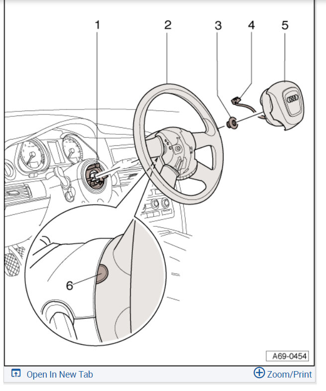

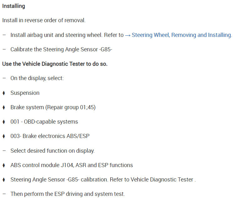

I recently replaced my clockspring following directions from someone with experience. Then I tried to calibrate the SAS with my OBD2 and it won't go through it seems. And then my ABS light randomly turned on after I accidentally did an ABS component test.

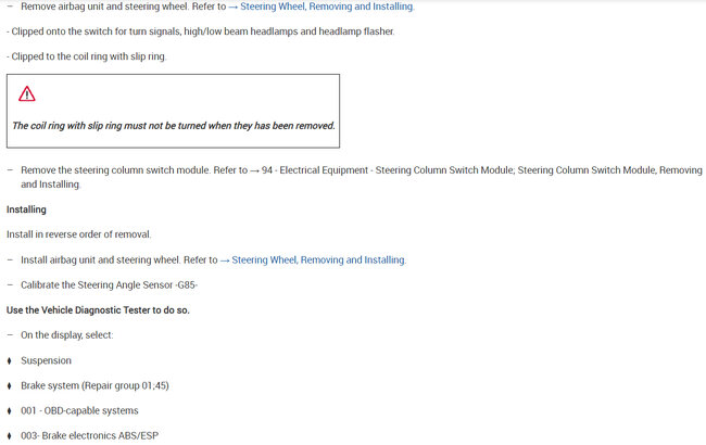

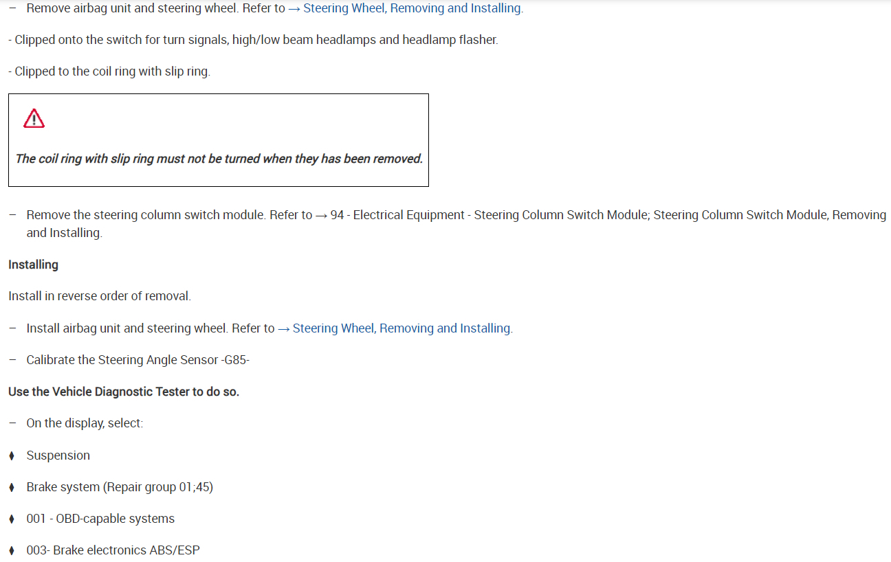

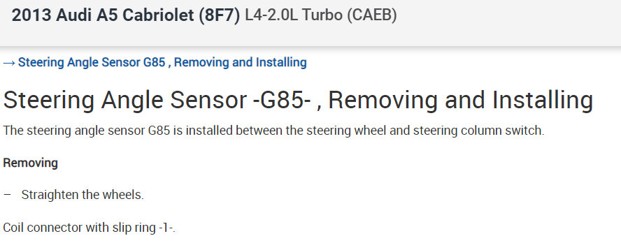

We need to check the codes to see what's going out, this video can help. to me it sounds like the clock spring is defective or not installed correctly.
https://youtu.be/HvooM1X2SDs?si=FO9z92BvSGo6ZuYH
Also, did you clear the codes once the repair was done? Here is how to install the clock spring correctly. I see the steering angle sensor is integrated into the spiral wire as well which will light the ABS light. Check out the images (below). Please upload pictures or videos in your response of any problems so we can see what to help you with.
