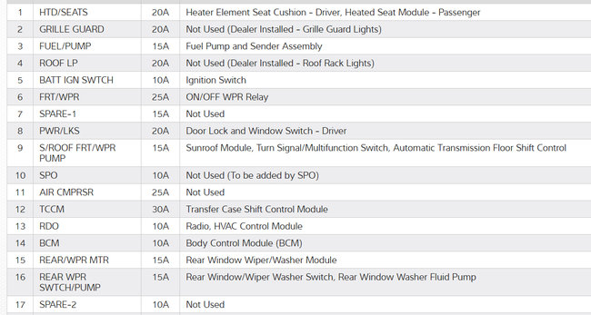

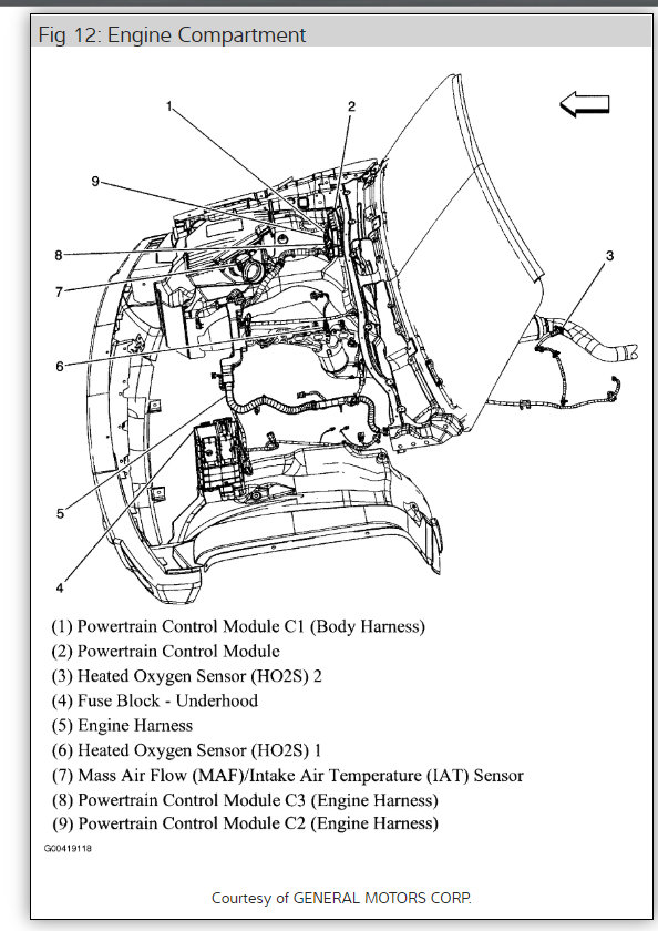

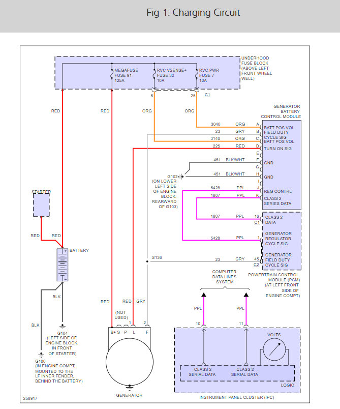

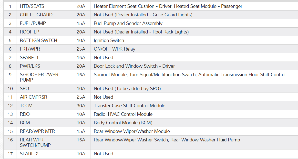

I have a new battery and new alternator, when the SARVC is unplugged it charges at the default 13.7 volts. If I plug the SARVC in I get no reaction at all from the ignition. No lights external or dash and no crank. When driven it will hiccup and throw P0106 code and if going uphill when it hiccups it dies and takes two to three minutes before it will crank. At this point I'm thinking PCM or engine wiring harness. Mostly the wiring harness. Addendum; I have no tech 2 just obd reader and doubt the computer is a problem because I can see it fine. Will have it checked Monday at a shop. Suggestions?
Mar 7, 2019 at 10:49 AM
  • 55,443 POSTS

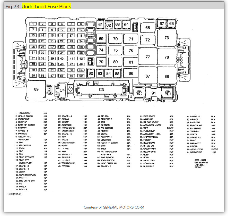

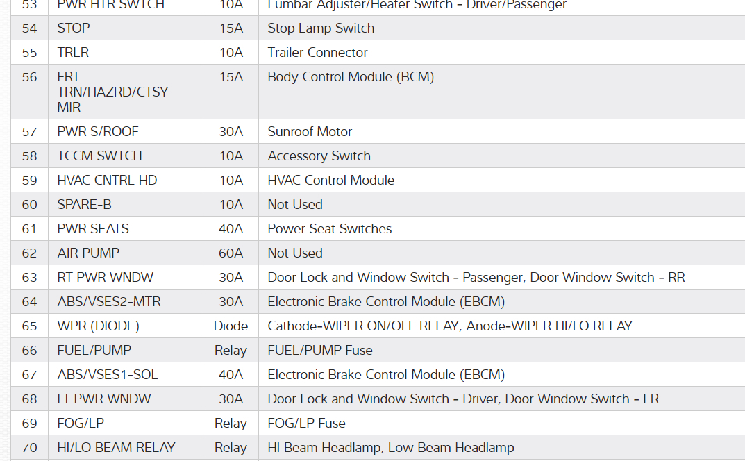

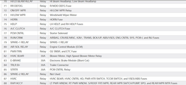

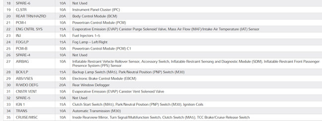

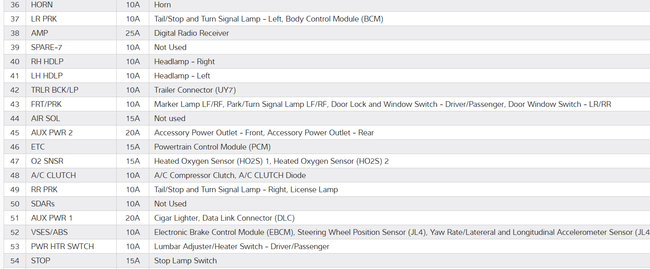

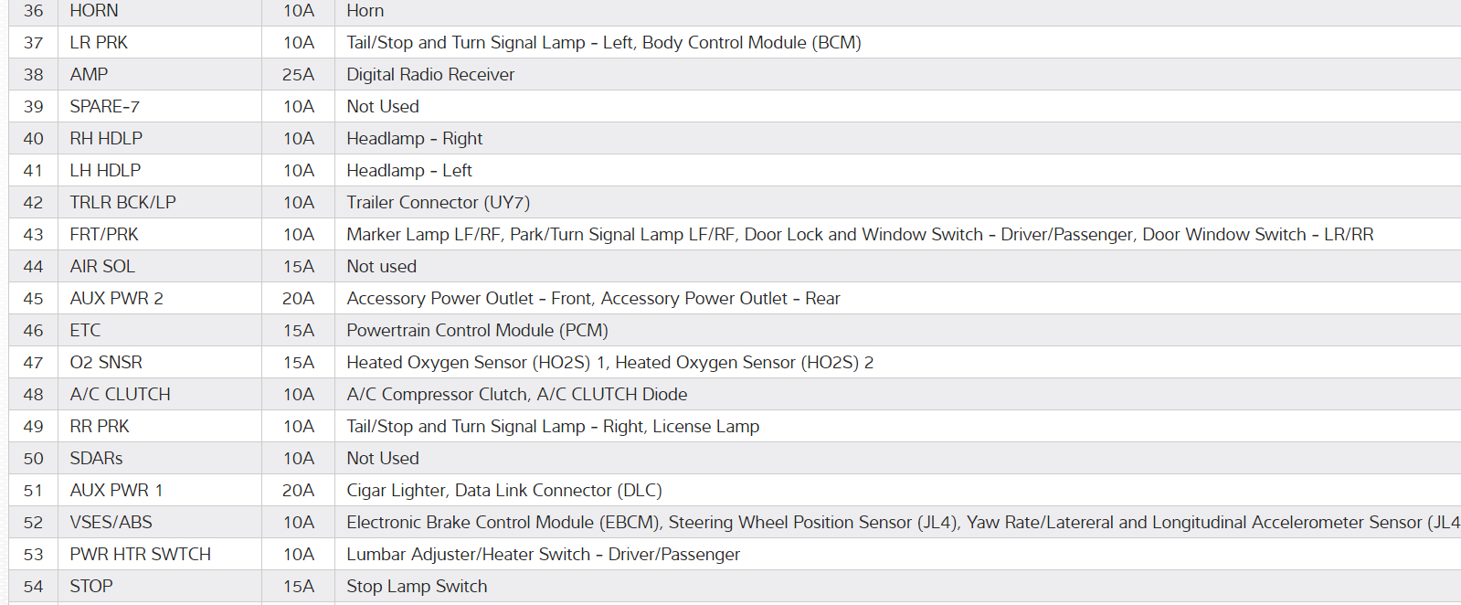

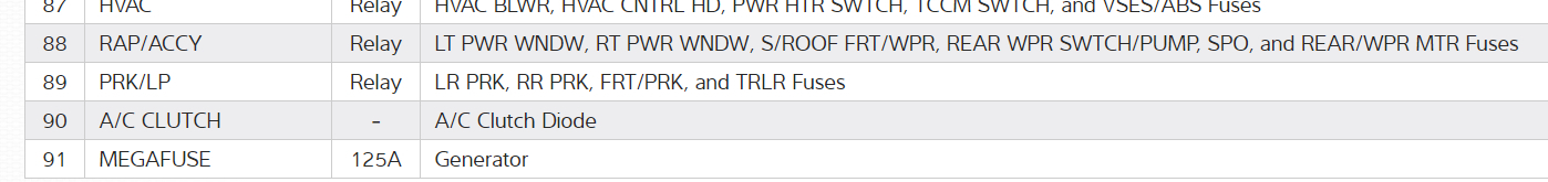

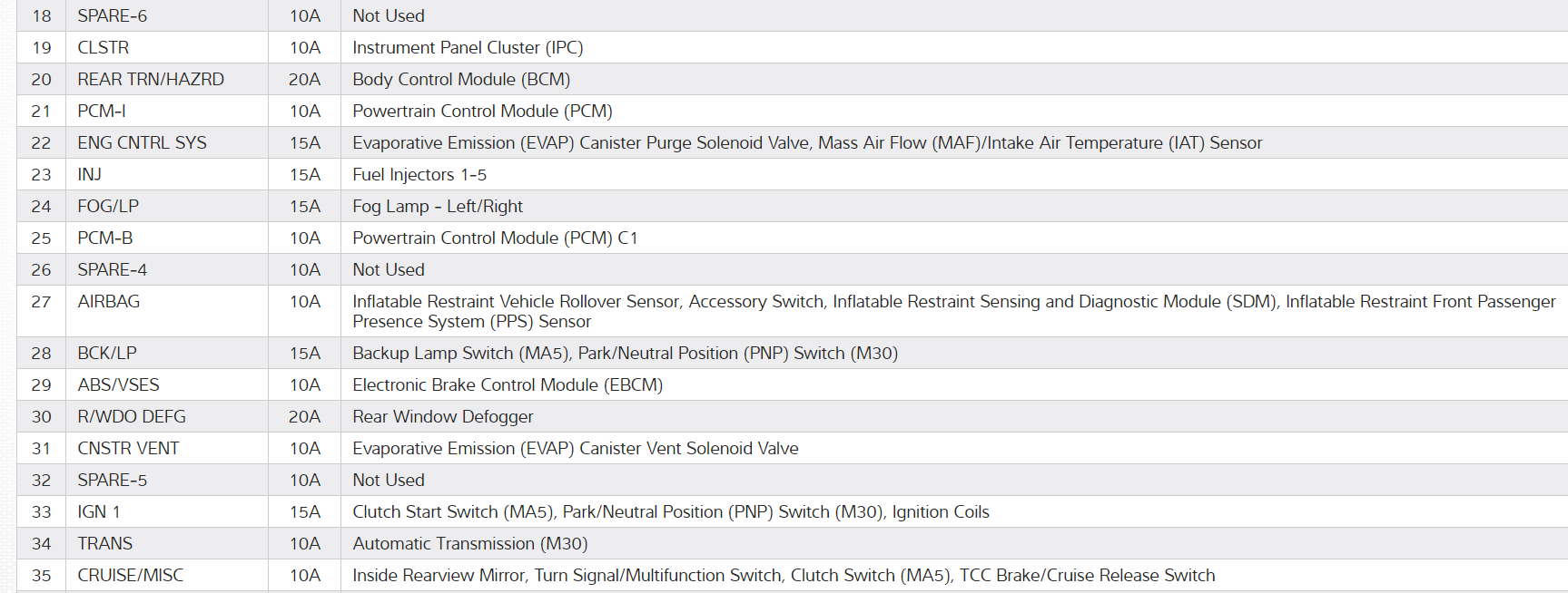

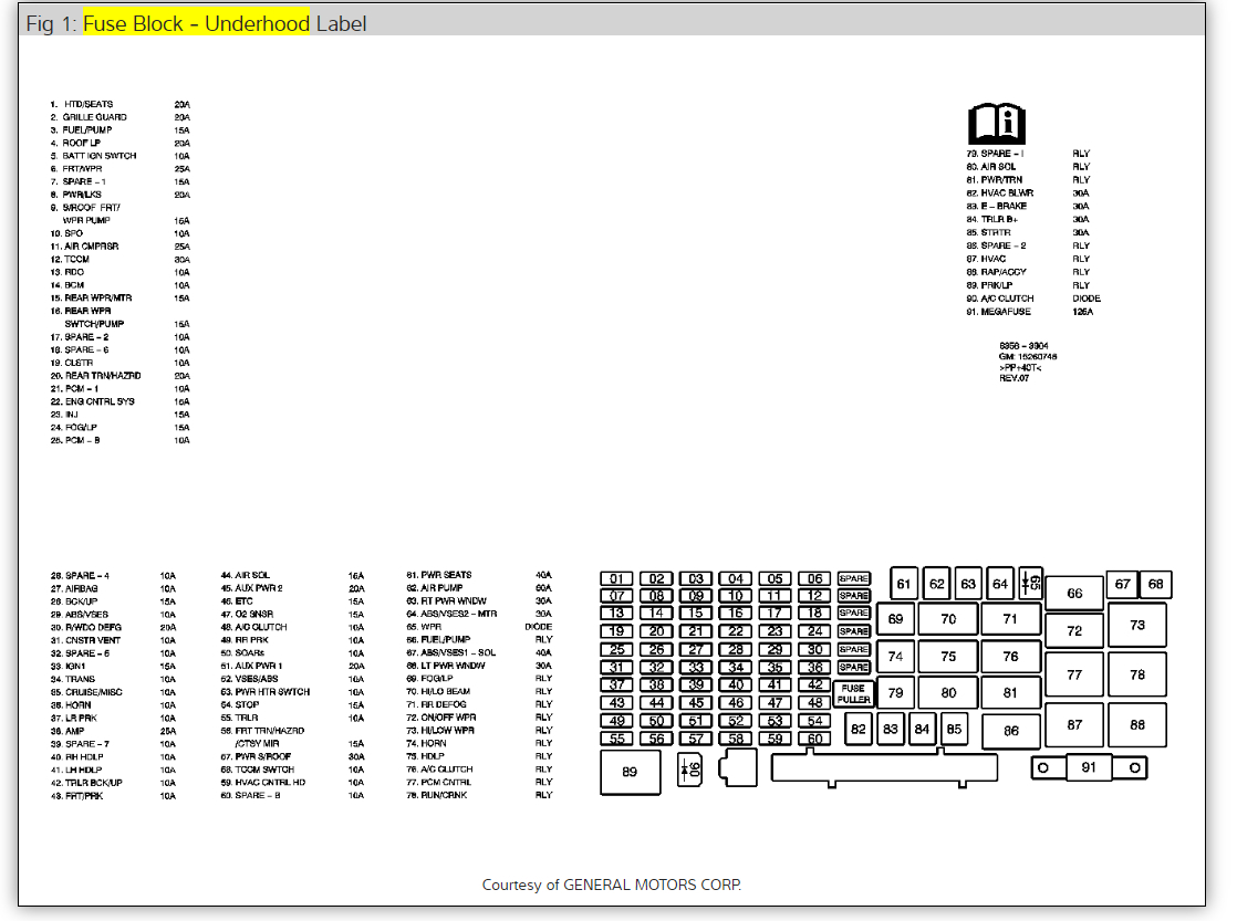

Do you have power at the RVC power fuse # 7? Here is a guide to help us test and the alternator wiring diagrams so you can see how the system works and the fuse location as well:
