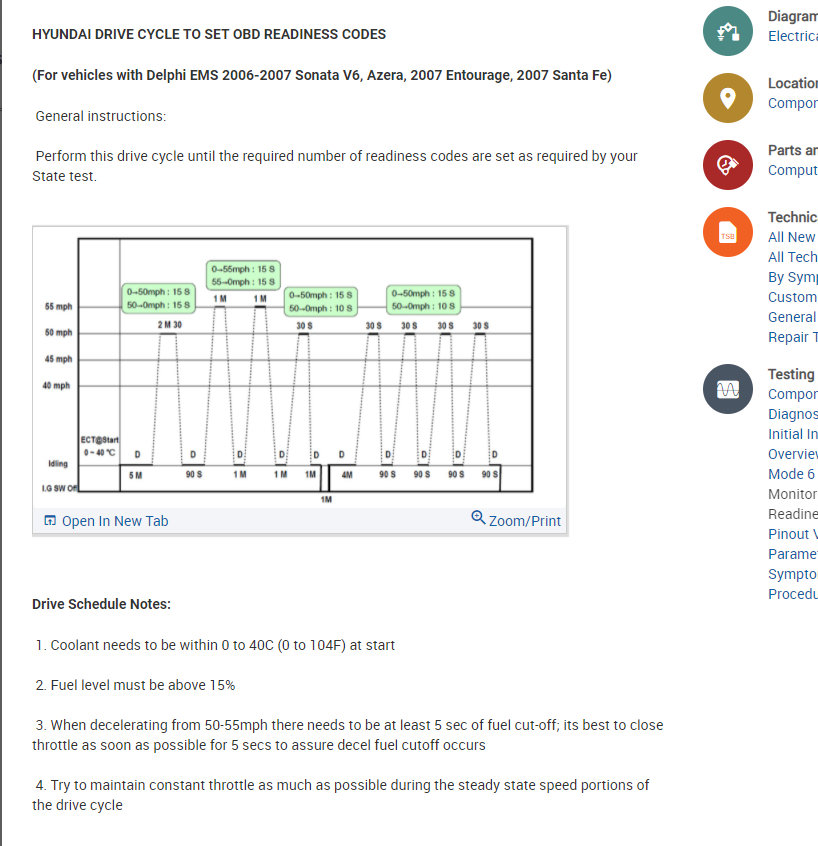

I have an OBD2 scanner and I use it with Car Scanner Pro, in the Noncontiguous Monitors option I get this results:
High sensor voltage for switch time calculation (constant) - Monitor ID (MID) $04
Component ID - $60
Value=70 Minimum=0 Maximum=0 Result=Failed
Manufacturer defined - Monitor ID (MID) $04
Component ID - $46
Value=1264 Minimum=0 Maximum=70 Result=Failed
Component ID - $46
Value=2566 Minimum=0 Maximum=3 Result=Failed
Manufacturer defined - Monitor ID (MID) $0A
Component ID - $2F
Value=4422 Minimum=0 Maximum=2626 Result=Failed
Component ID - $47
Value=47104 Minimum=0 Maximum=40518 Result=Failed
Vehicle listed above is a GLS.
Aug 15, 2021 at 9:51 PM

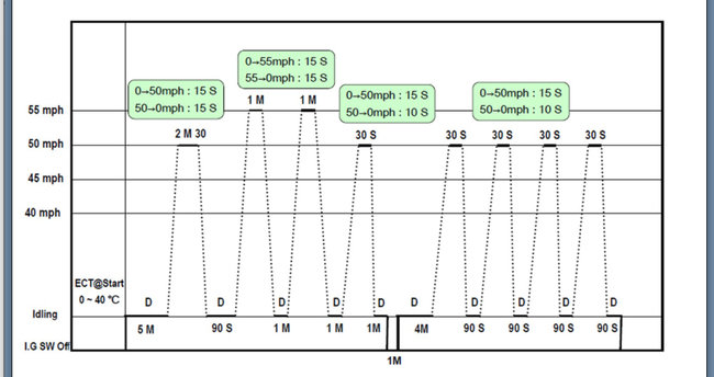

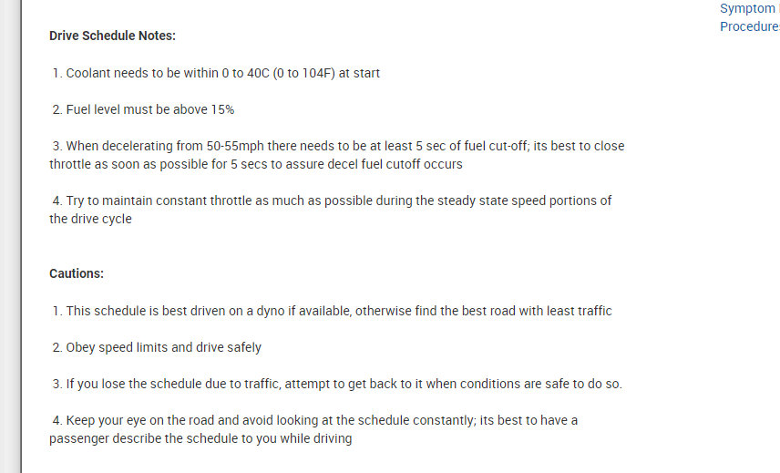

This is telling you that you have a system monitor that has failed a system test but these values are code to the scan tool but that scan tool is not compatible with it so it is just displaying this string of info.
Do you have any codes or any performance issues? Is so what are the codes?
More then likely this is the catalyst monitor or others that has failed but again, this info does not tell us this as it is like the scan tool and computer are speaking different languages.
Let us know what the issue is with the vehicle and we can try and figure out what the cause is. If there is no issue then we are going to have to ignore this info or try and perform the drive cycle that I attached below and see if each of these switches to passed.
If it does then I was correct that this is the monitors that has failed.
