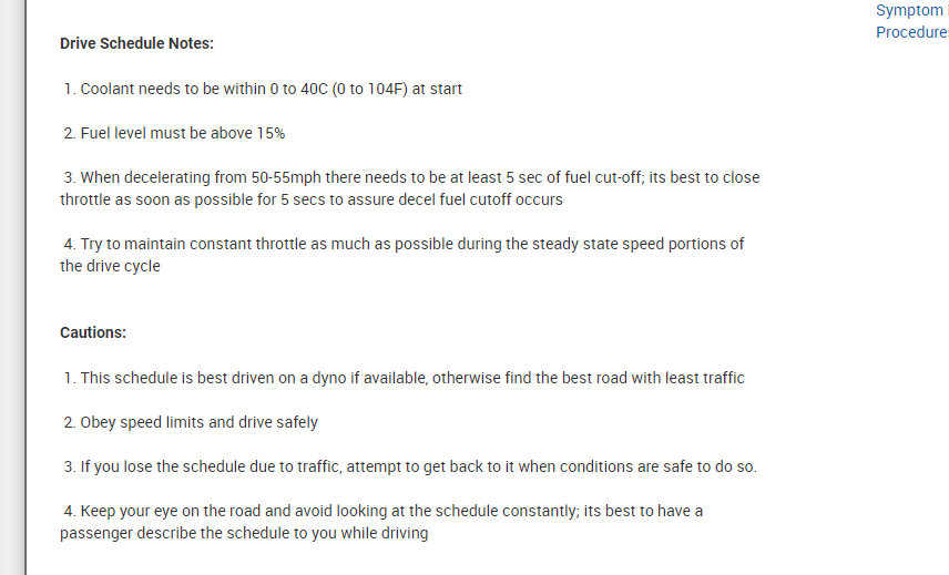

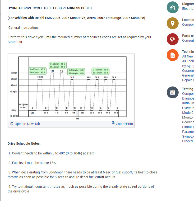

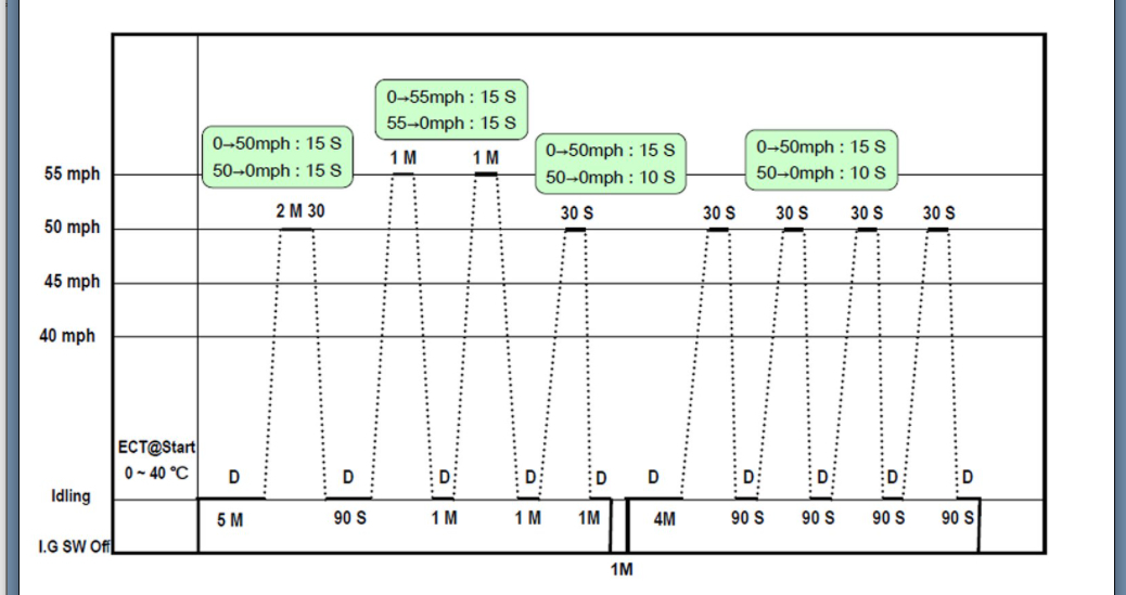

This is telling you that you have a system monitor that has failed a system test but these values are code to the scan tool but that scan tool is not compatible with it so it is just displaying this string of info.
Do you have any codes or any performance issues? Is so what are the codes?
More then likely this is the catalyst monitor or others that has failed but again, this info does not tell us this as it is like the scan tool and computer are speaking different languages.
Let us know what the issue is with the vehicle and we can try and figure out what the cause is. If there is no issue then we are going to have to ignore this info or try and perform the drive cycle that I attached below and see if each of these switches to passed.
If it does then I was correct that this is the monitors that has failed.
