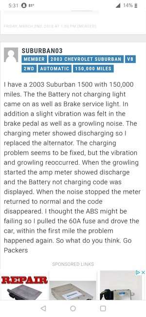

Started my truck this morning and the battery light came on with battery not charging message on the dash and then service brake booster message as well. I hear the same noise and feel the vibration in the brake pedal but it didn't last but just a minute and went away but the battery not charging message and battery light have continued all day is I've been driving. Did you pinpoint the issue? What is the solution?
Apr 30, 2020 at 7:44 AM
CHEVYDAVE420
  • 9 POSTS
Sorry, I'm new to this but I posted the question after reading this guy's post with the exact same issues. I've included a screenshot. Since the initial issue the blower fan on the air conditioner has started acting up, not going up or down normally with the fan switch and then remaining on low after turning the engine off. I don't know if these are related but they happened in the same day!

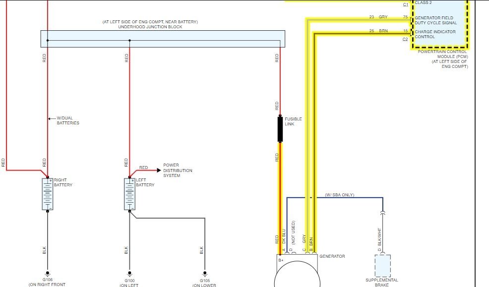

Good morning,
Do you have a voltmeter to do some testing at the battery?
You need to check the voltage with the engine off. Then run the engine and see what the voltage reads. You should have 14 to 14.5 volts with it running.
I also attached a wiring diagram for you. Verify power to the back of the alternator.
