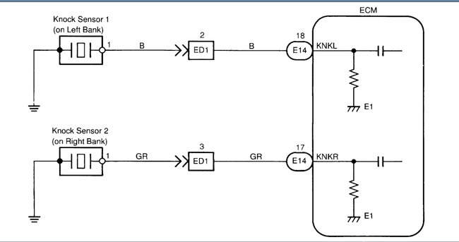

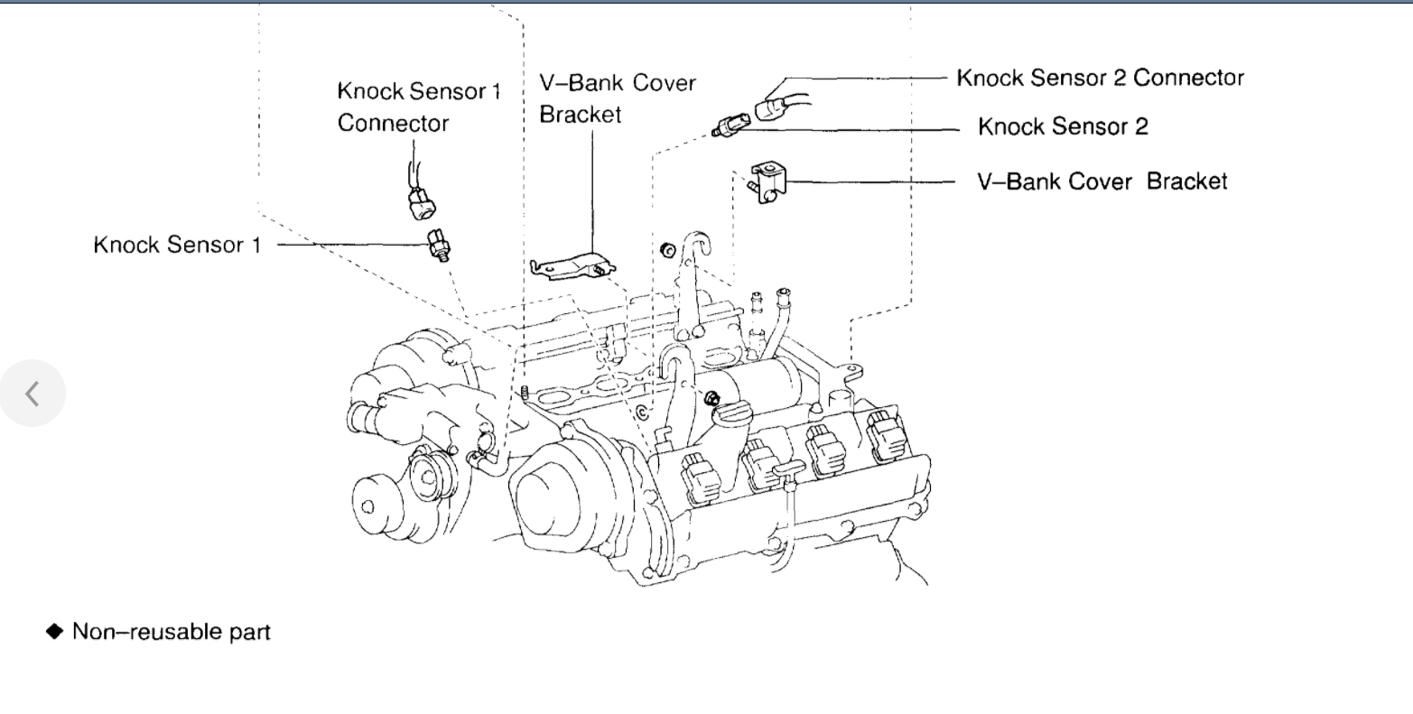

Changed knock sensors twice still getting check engine light.
Nov 7, 2020 at 2:02 PM
Good evening. This could be a number of things so we are going to need to start with the code to find out the issue.
Basically if you are getting a knock sensor code then that could be a sensor, wiring, control module, or even a connection issue.
So can you give me the code that is set so I can get the information for you?
https://www.2carpros.com/articles/how-a-knock-sensor-works
CIRCUIT DESCRIPTION
Knock sensors are fitted one to the right bank and left bank of the cylinder block to detect engine knocking. This sensor contains a piezoelectric element which generates a voltage when it becomes deformed, which occurs when the cylinder block vibrates due to knocking. If engine knocking occurs, ignition timing is retarded to suppress it.
