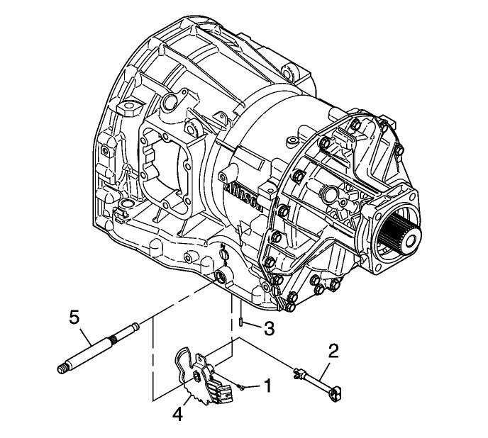

Cannot find where the safety neutral switch is mounted. I need to replace it. It is not mounted on the bottom of the transmission.

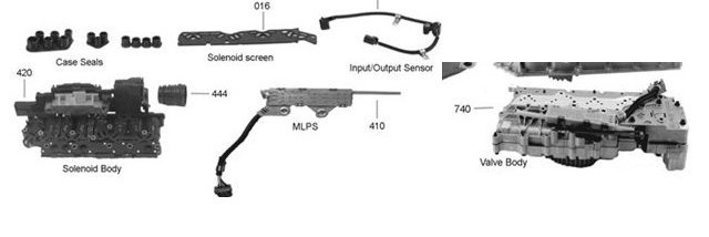

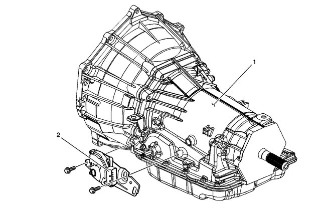

It is part of the transmission range switch. If you have the common transmission it is mounted on the outside of the transmission over the manual selector shaft as shown in the first picture. If you have the heavy duty truck with the optional Allison transmission it is inside the transmission and the selector shaft goes through it into the valve body. That is the second picture. What is the issue that is telling you it needs replacement?

Thank you I appreciate your quick reply. It is a Silverado 2500 HD 6.0 gas engine. I do not believe it is the standard transmission and I wish it was the Allison. It is the 6L90 I believe. I looked where you are showing me and I can see the pin and the wire going into the transmission but no neutral switch. When I look up neutral switches for my truck it looks totally different than the one that mounts to the side of the transmission. The symptoms are when I try to start my truck I get power starter working fine it just does not start. But usually after two or three times of trying to start it and it will fire up.

If the starter is working it is not the neutral switch. Or are you saying the starter tests okay, but does not start? What does it do if you select neutral? The 6L90 uses a slide switch inside the pan bolted to the valve body to tell the ECM which gear you have selected. It will disable the starter in any gear other than park or neutral.
